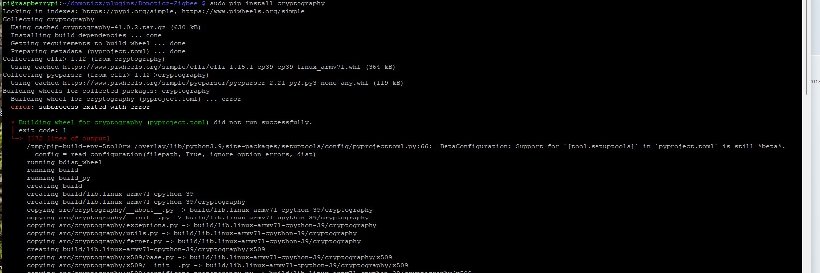

Is this update ready for download? I am running 6.3 ( with some troubles), git pull has no results, running latest. Hopefully is it the solution for the error i have. See also the topic i have started

I did the update manually, that worked. Stil have the problem with cryptography. I went back to 6.3, and try first to solve the cryptography error.
- Cryptography_fails_domoticz_2.jpg (201.65 KiB) Viewed 3447 times
Re: Zigbee for Domoticz - Version 7
Check the wiki FAQ
please kindly provide the full error list not a screenshot. Did you try to google it ?Rik60 wrote: Sunday 16 July 2023 16:54 I did the update manually, that worked. Stil have the problem with cryptography. I went back to 6.3, and try first to solve the cryptography error.

I already had opend a topic about this error, viewtopic.php?p=304579#p304579pipiche wrote: Sunday 16 July 2023 23:54please kindly provide the full error list not a screenshot. Did you try to google it ?Rik60 wrote: Sunday 16 July 2023 16:54 I did the update manually, that worked. Stil have the problem with cryptography. I went back to 6.3, and try first to solve the cryptography error.
What is the best thing to do? Create a new discussion here in "Zigbee"?
In the topic i already had uploaded the error file, here it is again.
I have google it, ther eare more users with this problems (not Domoticz users), i have tried some things, didn't help me.
Thanks for your replies so far.
- criptography.log
- (18.25 KiB) Downloaded 95 times

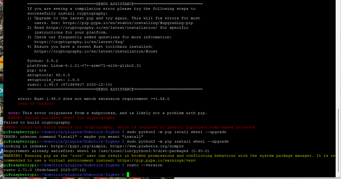

I have installed rustc, dit not help. I have created a new full requirements_txt log.
I have installed a different version of rustc than cryptography tells me? see rustc_versions
- rustc_versions.png (100.36 KiB) Viewed 3343 times
- requirements.log
- (21.34 KiB) Downloaded 122 times
Problem is solved. I have created a sd with Bullseye 32 bit as recommended now. I had created a sd with Bulsseye 32 bit lite first. That wasn't working for me, problems with Cryptography. The 6.3 version was working now, Installed version 7, had some small problems. In the folder Conf is a file DeviceConf.txt, i had to rename this file with an extra space, DeviceConf .txt. The Domoticz log file showed me. In the data folder i replaced DeviceList-21.txt with a file from a backup.
So, after some troubles everything is working now.
