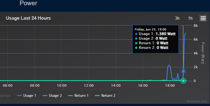

Hi there,
I have an P1 capable Power Meter installed and am pulling the data successfully via USB cable to my Domo.
The P1 Meter only delivers total values but no current usage. Luckily Domo calculates the usage out of the given data (see first screenshot).
Now my problem: If I pull the data via API, I only get Zeros for Usage and UsageDeliv:
(The Board forced me to cut some values, full API call and result are in the attachment

"Usage" : "0 Watt",
"UsageDeliv" : "0 Watt",

Any chance of getting the calculated usage values via API?

Power Meter in Domo
Power Meter in Domo
