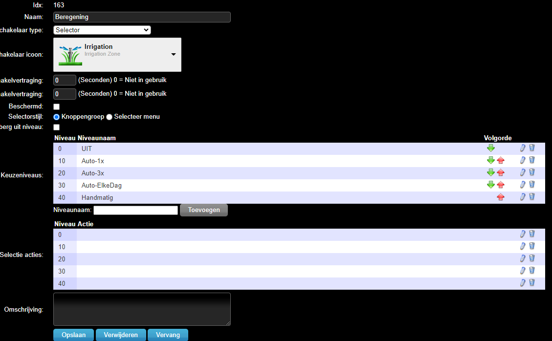

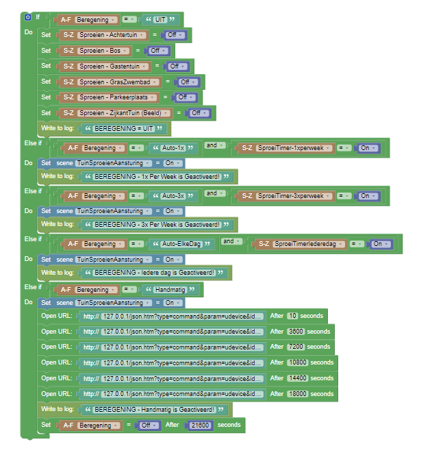

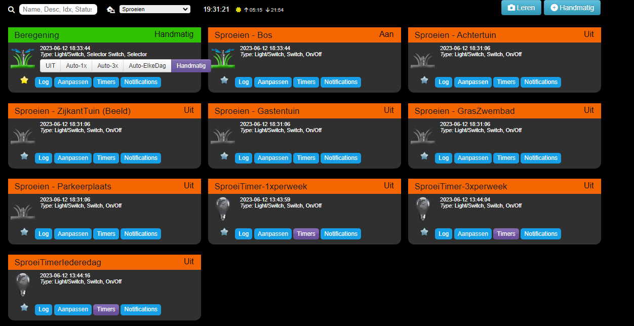

I made some virtual devices:
1 timer device for Once a week
1 timer for 3 times a week
1 timer for everyday

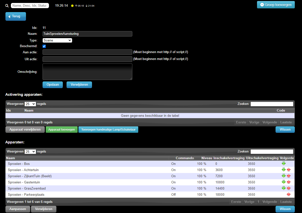

1 scene for activating the timers INSIDE the scene > this is the main scene that do open and close valves after some time..
1 blocky script that trigger the virtual programs of the timers and ofcourse this blocky activate the manual override
the manual knob just activates the scene > On

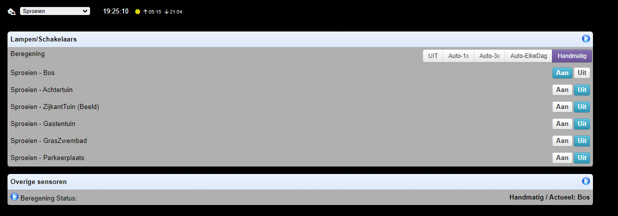

Also what i did is an update status to a text device so we can see wich zone is activated in the manual program.

Blocky Script:
Multiple Timers for the Zones:
Timers:

Selector Switch
Selector Switch
Devices / Text Status
