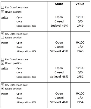

Correct, but the output value of the switch is still 0/70 Like in "0" for state and "70" in percentage of position. And that's what I need to set the position of the blinds.
Like 0 is in my case open on the actual blinds and 100 is fully closed. So if I press open in either setting it will output 100 and then the blinds will close 100%

I made a small table, in each position the value remains **/100 when closed and **/0 when open, this 100 and 0 is the one used in the script to set the blind to the right height.
By itself that's not a problem, but clicking on the icon closed or open doesn't work this way.
So if I press "close" the value should be 1/0 and "open" press 0/100.

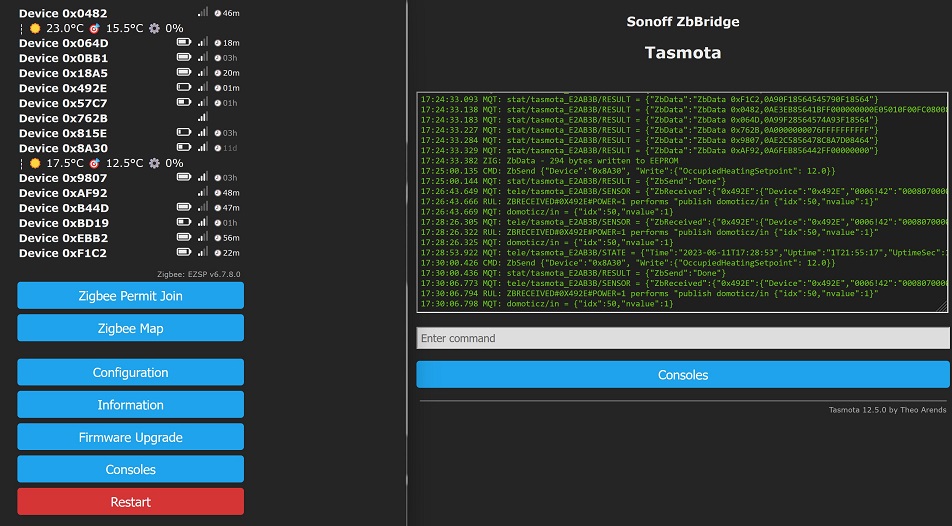

I had a search trough the internet for all commands for the kadrilj and trädfri and so on, only working commands where the ones from tasmota zigbee page.
I paired the blinds with my zigbee bridge (sonoff) and that worked out, so with monitoring the feedback and the tasmta zigbee page I was able to create some rules and commands to make it work.
So far the blinds are working with the scritps installed, except the open/close button :-)

Kedi wrote: Sunday 11 June 2023 15:38 I am confused? You flashed your Sonoff ZBBridge with Tasmota?
Yep works fine, I like the console so I can see what's going on. If it was up to me I would flash all my device to tasmota :lol:
Only devices that don't have tasmota is my shelly dimmers, shelly trv's, shelly 3EM and the zigbee devices them selfs. All the rest is local trough tasmota. No node-red all works fine with rules. (little off topic :roll: )
10minute job https://zigbee.blakadder.com/Sonoff_ZBBridge.html

That's really easy, because it transfers the command directly from domoticz to the blinds.
Exactly like in the script above. Tasmota is only the middleman.
Domoticz gives an value when pushing open or close and this value won't change. So I think I have to live with it or work around it with an secondary blind switch and fiddle around.
