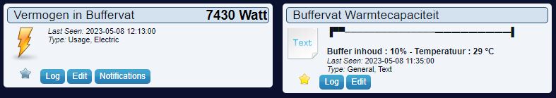

I have a 1000 liter hot water buffer tank where temperatures are measured at different heights.
With these temperatures I calculate a capacity number in the form of electrical power stored in a virtual device. When the entire vessel is at 80 degrees i consider it full, if full it contains about 50 kilowatts of heating power.
So far no problem. I notice a daily loss of energy that i would like to compensate with electrical heating power from my solarpannels but how much to compensate i want to calculate.
