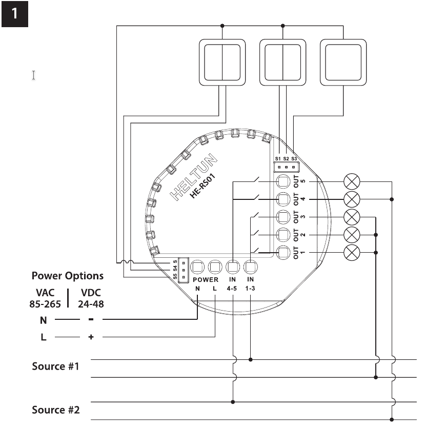

I would like to automate certain functionalities of our heating system. It offers 5 buttons to control the whole functionality of the heating system (each button has a context specific functionality depending on what is displayed on the control screen, the menu is pretty static).
So pressing these buttons in a certain order, activates a certain functionality of the heating system.
I would like to automate the pressing of certain buttons combinations ( button one (b1) first, one second later b5, three seconds later b2, each single morning at 7:00 a clock).
So what I am looking for is a single Z-wave device that can control these 5 buttons (once the wiring has been done accordingly) and
after searching the web, I found the "HELTUN Relay Switch Quinto HE-RS01" device that can control 5 outputs.
However, I could not find the information that Domoticz fully supports this device.
If it doesn't, then is there a similar device (offering at least 5 ouput/switches that can be controlled individually) that Domoticz supports?
I know that I could solve my problem using 5 single z-wave switch devices but due to the physical size of each device and the associated cost for each single one, my preference would be to have a single z-wave device that can control 5 outputs (my 5 buttons).

You should check zwavejsui if it supports it as that is what Domoticz will interface with. It seems it does: https://devices.zwave-js.io/?jumpTo=0x0 ... 0x0009:0.0
Next to that it seems that the output switches are not potential free. So if you connect this to your heating system it could damage it.
