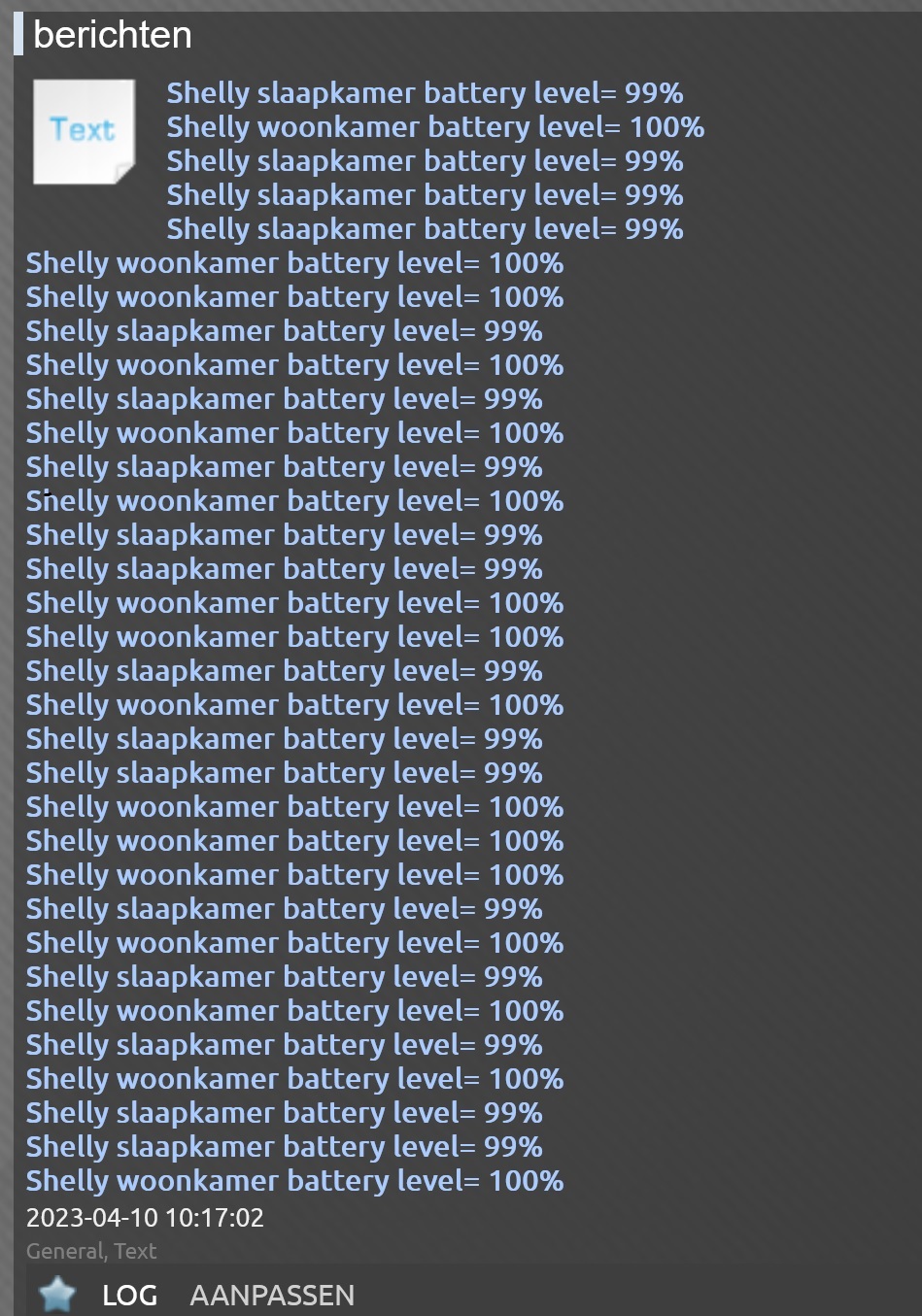

Only issue is now that the textbox is getting bigger after each update..
Is it possible to delete the textbox content before updating?

Did you use
domoticz.devices(258).updateText('')
before the first openURL in the isTimer section?
Incase that does not work with a space
domoticz.devices(258).updateText(' ')

Re: Textbox
Posted: Tuesday 11 April 2023 18:13
by jacobsentertainment
Not much to see here, sometimes one is a little later then the other. I checked but all have full wifi range (according to the shelly page)
 2023-04-11 18:10:04.008 Status: dzVents: Info: Shelly text: ------ Start internal script: #Shelly battery to txt: HTTPResponse: "trigger3"
2023-04-11 18:10:04.023 Status: dzVents: Info: Shelly text: ------ Finished #Shelly battery to txt
2023-04-11 18:10:04.298 Status: dzVents: Info: Shelly text: ------ Start internal script: #Shelly battery to txt: HTTPResponse: "trigger1"
2023-04-11 18:10:04.312 Status: dzVents: Info: Shelly text: ------ Finished #Shelly battery to txt
2023-04-11 18:10:04.432 Status: dzVents: Info: Shelly text: ------ Start internal script: #Shelly battery to txt: HTTPResponse: "trigger2"
2023-04-11 18:10:04.449 Status: dzVents: Info: Shelly text: ------ Finished #Shelly battery to txt
2023-04-11 18:10:04.977 Status: dzVents: Info: Shelly text: ------ Start internal script: #Shelly battery to txt: HTTPResponse: "trigger4"
2023-04-11 18:10:04.995 Status: dzVents: Info: Shelly text: ------ Finished #Shelly battery to txt
2023-04-11 18:10:06.543 Status: dzVents: Info: Shelly text: ------ Start internal script: #Shelly battery to txt: HTTPResponse: "trigger5"
