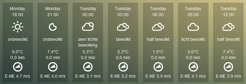

For the weather block:
I suggest to not use 31 as block name, but for instance 'myweather' to prevent mix-up with Domoticz devices. Don't forger to change it in the column definition as well.
Further, if you recently created a OpenWeatherMap account, then you can only use the new OpenWeatherMap 3.0 API.
See:
https://dashticz.readthedocs.io/en/beta ... .html#owm3
The new owm3 is only supported in the most recent Dashticz beta version.
You can switch to the beta version, and update to the latest version with:
git checkout beta
git pull
To use the OWM3 API, create your block as follows:
blocks['myweather'] = {
  type: 'weather',
  provider: 'owm3' ,  //Add this line
  layout: 1,
  count: 7,
  interval: 3,
This only will work if you've switched to the latest Dashticz beta version!
