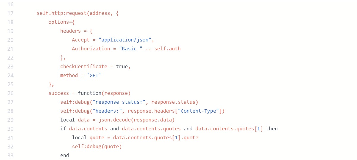

I have a RFXCOM card that I use with Domoticz. 2 years ago I bought a Fibaro HC3. A friend helped with a script to control Domoticz from a Fibaro Quick App. Everything has worked beautifully until some weeks ago where the QuickApp started crashing and therefore not allowing more control of my blinds (Fibaro --> Domoticz).
I get the following message in Fibaro's log:
[15.03.2023] [19:14:28] [TRACE] [QUICKAPP41]: UIEvent: {"eventType":"onReleased","elementName":"button3","deviceId":41,"values":[]}
[15.03.2023] [19:14:28] [DEBUG] [QUICKAPP41]: Close
[15.03.2023] [19:14:28] [DEBUG] [QUICKAPP41]: Begin
[15.03.2023] [19:14:28] [DEBUG] [QUICKAPP41]: Get
[15.03.2023] [19:14:28] [DEBUG] [QUICKAPP41]: End
[15.03.2023] [19:14:28] [DEBUG] [QUICKAPP41]: Closed
[15.03.2023] [19:14:28] [DEBUG] [QUICKAPP41]: response status: 401
[15.03.2023] [19:14:28] [DEBUG] [QUICKAPP41]: headers: text/html;charset=UTF-8
[15.03.2023] [19:14:28] [ERROR] [QUICKAPP41]:QuickApp crashed
[15.03.2023] [19:14:28] [ERROR] [QUICKAPP41]: main.lua:30: attempt to index a nil value (local 'data')[/color]
[15.03.2023] [19:14:30] [DEBUG] [QUICKAPP41]: onInit
Any suggestions? After doing some research it seems that it is Domoticz that has changed something, but I am unaware of how to give a solution.

401 is Unauthorized response status code. Domoticz 2023.1 changed its security options. Look at changelog or wiki. Look for trusted networks and basic authorization.
