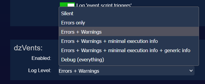

In my dzVents-scripts I use logging to monitor events.
But there so many events (like: EventSystem: Script event triggered), I donn't care (mostly).
So, I use LOG_ERROR do log "my" events.
But then, I can't differentiate between "my loggings" and errors.
So, I added also warnings to the log-system (see attachments).
Maybe something for the beta-channel?
(git patch-file avaiable - but can't upload here)
Possibility to log warnings (dzVents)

I like that, great idea.

It would be nice to treat most DzVents logging as Info logging instead of status logging.
Then we could just use the standard Domoticz Info/Status/Error log levels and filters and no need to add a Warning log level.
All those "EventSystem: Script event triggered" log lines should be info logging instead of Status.

@waltervl Yes, but there so many more locations in the code to change - for example - status to internal, that a new loglevel was easier to implement.

In addition, I would opt for a LOG_NONE level, to suppress errors from some specific scripts (in my environment, a call to the Denon http API always gives an error (http://192.168.x.y/goform/formiPhoneAppDirect.xml?MV495) when changing the volume.)
