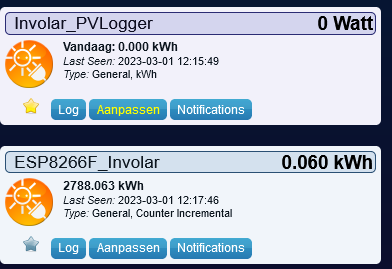

The S0-interfaces being read by ESP8266s_with_ESPEasy it is not difficult to forward the values to virtual devices in Domoticz.
Other question is how to extract the data from those virtual devices.
The attached screenshots for 2 devices in Domoticz should be technically equivalent,
but question arises, how to extract 'meaningful' values from the svalue of the incremental counter.
[Note that (due to 'switch' at side of ESP8266), a small difference exists in the widgets,
because IDX=786 presently has no feed, while IDX=788 has an active feed]
Where to find an explanation for the layout of the svalue of the incremental counter?

Walter,
Setting the virtual device Counter_incremental is not the question,
but reversely how to read&translate the very long string of digits in the svalue to values which represent Power or Energy, like the output from virtual device 'General,kWh'.
Or is the translation as simple as described below?

I have never seen these strange values of incremental values. But I would not give too much value to the values in the event editor list. You are the first to ask this question, so why document?
Better check the device with an api call eg
/json.htm?type=devices&rid=IDX
Or read the source code. Or check with Lua or Dzvents what ere the values. Or even better check the SQLite database if you really feel into this.

Walter,
Would not ask the question if just 1 Virtual Device of type Counter-incremental would show such strange svalue, but it happens at all similar Domoticz-instances being similarly fed by ESP8266s_ESPEasy which have counters reading S0-interfaces with setting Delta.
Already earlier tried
and
and that produces rather normal read-outs for CounterToday and Data, respectively for Counter and CounterToday.
However, RID=788 of type Incremental misses the output Usage (or similar), and therefore returned to have look at the layout of the svalue to find an alternative setup for data-extraction.
Anyway, perhaps found a circumventing solution by means of a small Python-script, but have to await testing tomorrow when the sun shines and the counters start ticking ......
