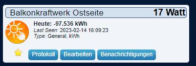

Running the Power Montitoring Plug in Domoticz gives me this Data:
You see "Heute" there is a very Strange amount of Data.

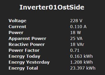

This is wrong, cause the Plug itself, howing this Data:

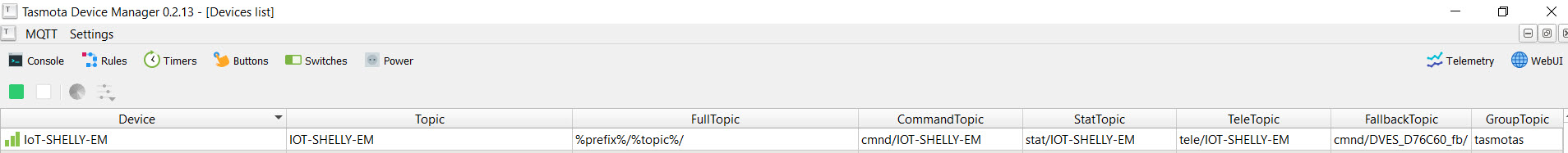

Sample of MQTT message :
07:05:15.494 MQT: tele/IOT-SHELLY-EM/SENSOR = {"Time":"2023-05-31T07:05:15","ENERGY":{"TotalStartTime":"2023-05-31T04:59:57","Total":[3.035,-0.024],"Yesterday":[-21.184,34.466],"Today":[3.035,-0.024],"TodaySumImport":3.011,"TodaySumExport":0.000,"ExportActive":[-7369.173,1077.272],"Period":[8,1],"Power":[440,54],"ApparentPower":[632,326],"ReactivePower":[158,-211],"Factor":[0.70,0.16],"Frequency":50,"Voltage":235,"Current":[2.526,1.080]}}
07:06:15.466 MQT: tele/IOT-SHELLY-EM/STATE = {"Time":"2023-05-31T07:06:15","Uptime":"1T02:04:34","UptimeSec":93874,"Heap":22,"SleepMode":"Dynamic","Sleep":50,"LoadAvg":19,"MqttCount":3,"POWER":"OFF","Wifi":{"AP":2,"SSId":"WIFI_xxxxxx","BSSId":"F8:08:4F:1E:5D:81","Channel":11,"Mode":"11n","RSSI":100,"Signal":-39,"LinkCount":2,"Downtime":"0T00:04:08"}}
I have use the plugin Tasmoticz and all values are corrects. I have tested with homeassistant and I have also the correct values.
Unfortunately with the MQTT Discovery already in core Domoticz it is not an good solution for all cases. (Shelly EM for me)
