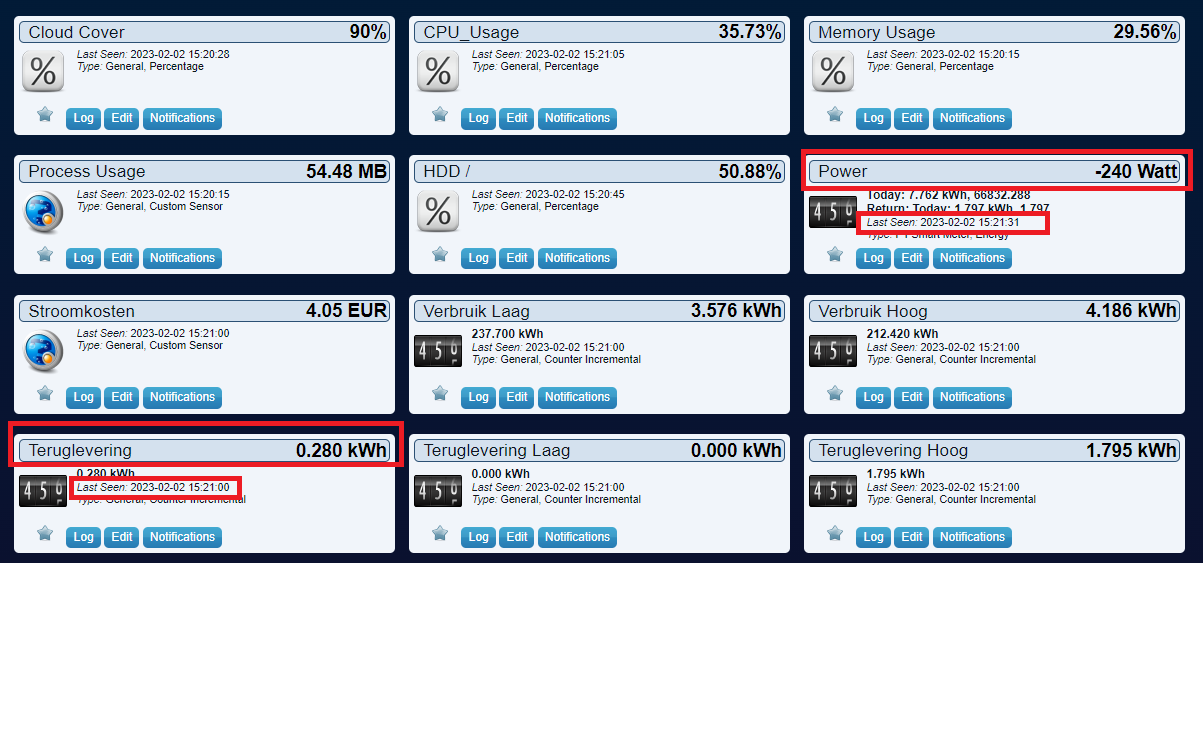

Since today I own solar panels.
Yesterday the power meter (P1) showed positive values (usage), today since the solar panels it shows a negative value.
The negative value of the power meter (usage) shows the same value as the Solar meter (production) but with a positive value.
This while the minimum consumption is about 310 Watts.
As example:
Solar production is 500Watts
Power meter consumption was previous +310
Now it shows -500Watts
I would expect -310 (usage) + 500 (production) = +190 Watts (so a positive value on the power meter)
Or am I miscalculating? how should I read, interpret these values?
As example:

I get these readings: Without anything done to power meter...willemd wrote: Thursday 02 February 2023 15:05 Are you sure these are all actual values and all measured at exactly the same moment?
Your calculation is correct, but if there is a time difference between the measurement (i.e. import into domoticz) of the solar production and the data you get from the power meter (grid consumption or return) then the numbers could still be correct.
Power meter is standaard P1 reading (cable connected from Smart Meter to Rpi with Domoticz.
"Teruglevering" is a dummy I use a script to extract info from Smart Meter T1/T2.
local fetchIntervalMins = 1 -- (Geheel) Minutenfrequentie van deze scriptuitvoering 1 = elke minuut, 10 = elke 10 minuten, enz.) Moet een van (1,2,3,4,5,6,10,12,15,20,30) zijn.

}At this moment a washmachine is on, I would expect the value of P1 meter usage would we a positive value....

Value1: total usage low tariff
Value2: total usage normal tariff
Value3: total return low tariff
value4: total return normal tariff
value5: actual current usage
value6: actual current return
The P1 device shows indeed the smart meter values, but, as explained, not the total production of the solarpanels. Just try on a sunny day (with stable production) to switch on a heavy consumer (dishwasher, water cooker) and you will see your P1 values change even if your solar production would be stable.
To illustrate with my numbers of today:
P1 usage: 3.335 kWh
P1 return: 0.748
PV production 1.862
so 1.862-0.748=1.114 of the PV production used internally.
total electricity usage is 3.335+1.114=4.449 (= 3.335-0.748+1.862)

So let me try to understand this.willemd wrote: Thursday 02 February 2023 17:00No, not correct, but:Xavier82 wrote: Thursday 02 February 2023 16:31
When looking at the data of P1 I see 6 values seperated by ",".
Is this:
Value 1: Total Usage of T1 (Night)
Value 2: Total Usage of T2 (Day)
Value 3: Totale Delivery/Production (Solarpanels) T1 (Night)
Value 4: Totale Delivery/Production (Solarpanels) T2 (Day)
Value 5: Current usage
Value 6: Current production
Is this correct?
P1 usage: 3.335 kWh
P1 return: 0.748
PV production 1.862
The default Power device shows OR usage OR return WHEN the value of Usage is greater then the return it shows usage and when the value of Return is greater then usage it shows return?
Clear about the values 1 to 6 thanks, we meant the same
So what to do to solve this issue?
I was thinking about creating a dummy device "Power Grid" and "Power Solar".
These dummy devices are type energy with incremental counter. They count the usage (=Power Grid) and the production (=Power Solar).
The current Power device shows current setup and shows (depending on value) OR usage OR production/return based on actual readings.
I create a 3third dummy device which shows de difference between usage and production.
Ofcourse the dummy switches are updated based on a script.
Could this work?
I would just expect based on P1 Smart Meter data I could see the current usage and current production AND de difference (used on internal powergrid in the house).

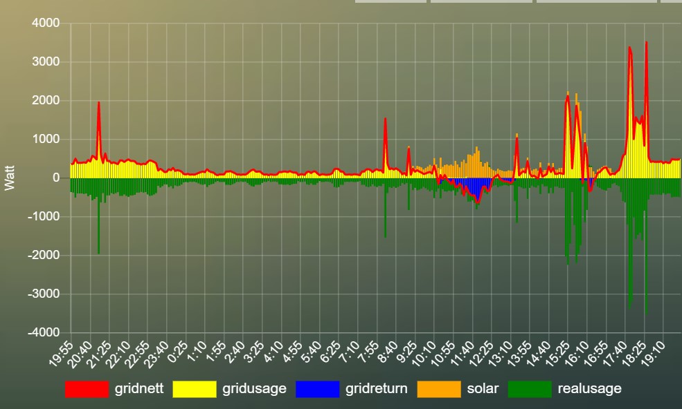

In terms of devices I have:
1) a 1 phase P1 meter device showing the 6 values you mentioned (updated via a lua script that reads the values from the API).
2) a 1 phase kWh meter device showing solar production (update via a lua script that reads the values from the API).
3) a dummy kwh device showing the real usage (updated with a dzvents script making the calculation shown before).
4) several costs tracking devices and user variables with electricity prices and costs
5) several devices to calculate theoretical solar production based on weather and sun position and compare this to actual production
etc.
etc.
etc.
I think you will need to first 3 as well in one way or the other. If you get production data from each panel you will need more devices and then consolidate it to a total number. And if you have 3-fase you will need more and again consolidate (or does the P1 still deliver the consolidated totals in case of 3 fase? I will switch to 3 fase later this month)
Then you can do graphs like this is dashticz for example.
The top/positive values show source of power (either grid or solar panels), the bottom/negative values show destination of power (either grid or own usage)
Note you can see very small yellow parts (grid usage) below some orange parts (solar production) where there is also blue (grid return). This depends on the measurement interval. A switch from usage to return can occur within the measurement./display interval
The principle remains the same. You will need the PV production data and the P1 data to get a complete picture.
