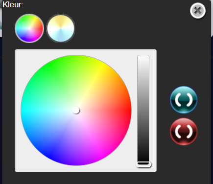

in all cases: Normal RGB operation works fine. E.g. if i click a color in domoticz in
i get an output message in mqtt like:
{"color":{"b":255,"g":141,"r":106},"state":"ON"}

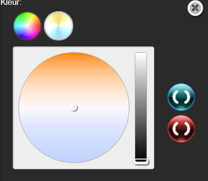

however since i have to use rgbw(w): i can also set a color using this dialog
and if i then pick a color i just get something like:
{"brightness":3,"state":"ON"}
so i am missing the color values.

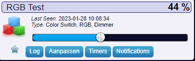

Also the dimmer on the normal switch works fine:
The bad news is: i think there is a bug in domoticz: Cause nothing is updated if i try to set the dimmer value in this dialog:
nothing is updated

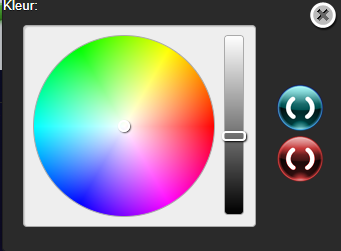

- i set a dimmer using the dimmer on the switch: domoticz sends {"brightness":124} in the command topic (correct behaviour)
- i set a color using the color picker: domoticz sends {"color":{"b":77,"g":132,"r":255},"state":"ON"} in the command topic (correct be
- but when i set the color brightness using the bar in the color picker, it again sends the exact same message. No brightness info is sent:
I know what you want to ask: I verified using mosquitto_sub. This is not the previous message. see mosquitto_sub output:
{"brightness":124}
The 3 messages of the 3 above actions. The last one should have had some brightness info, cause i changed the brightness slider in the color picker
