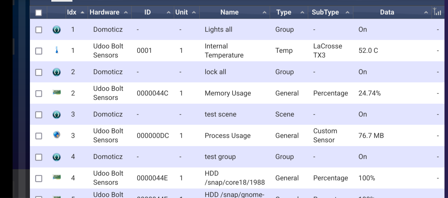

This is really strange as IDX of group/scene can be the same as normal devices by design. Domoticz can handle this and should not lead to data loss. Perhaps a script or plugin is mixing things up?
Below my device list with double IDX

Well there is a difference between devices and non-devices (like scenes/groups) so this is normal and have always been like this
The database tables are also different
