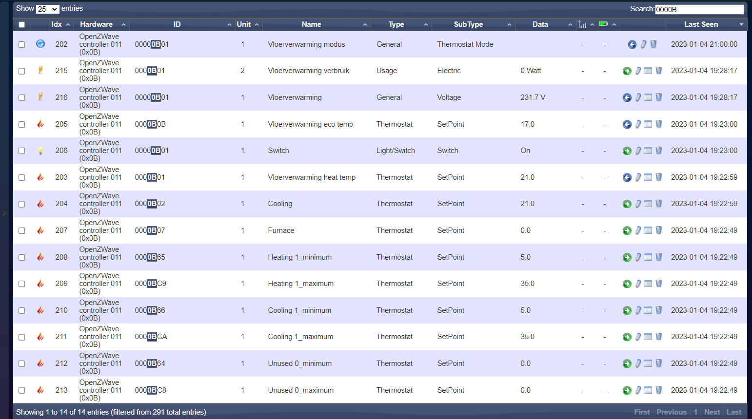

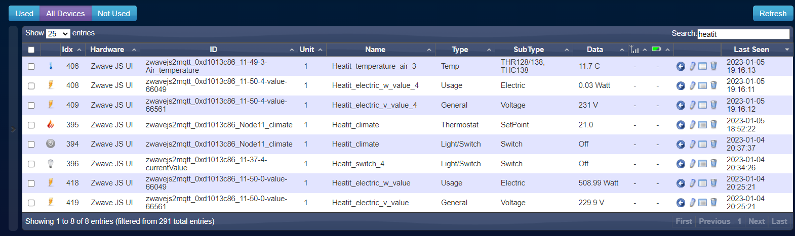

After some work I've successfully migrated from OpenZwave to zwavejs. Most devices are working properly, though there is one problem with my Heatit floor heating thermostat (Z-TRM2fx / https://devices.zwave-js.io/?jumpTo=0x0 ... 0x0202:3.0# ).
Using OpenZwave in my old configuration there were 14 devices created for the thermostat. With Zwavejs there are only 8 created, and I miss some of the important ones, like Thermostat mode and Heat and Ecoheat setpoint, which I need for my scripts. Checking zwavejs I see the device correctly represented (all settings are available), but when I go to the 'Home Assistant' tab I see a limited list of devices (only 6 at the moment) I have changed some settings on the thermostat and in Zwavejs to help it sending something do Domoticz, but this doesn't have the desired effect. Can somebody help me to find a way how to share the other settings with domoticz so it will auto create the new devices?

I have the same issue, with the same thermostat. Do you have an update?
