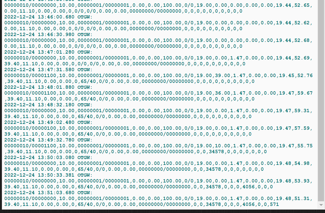

I am trying to get the readouts of the nodoshop opentherm gateway (using the fixed LAN interface).

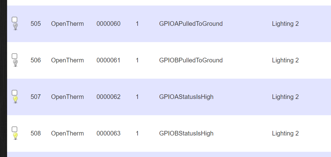

But i am struggling to get the readouts. I do see a nice valuestring in the log, but in the devives i only see 4 devives an named GIOAPulkledToGround/GIOBPulkledToGround/GIOAStatusIsHigh/GIOBStatusIsHigh. Why are all the other devices not inserted?

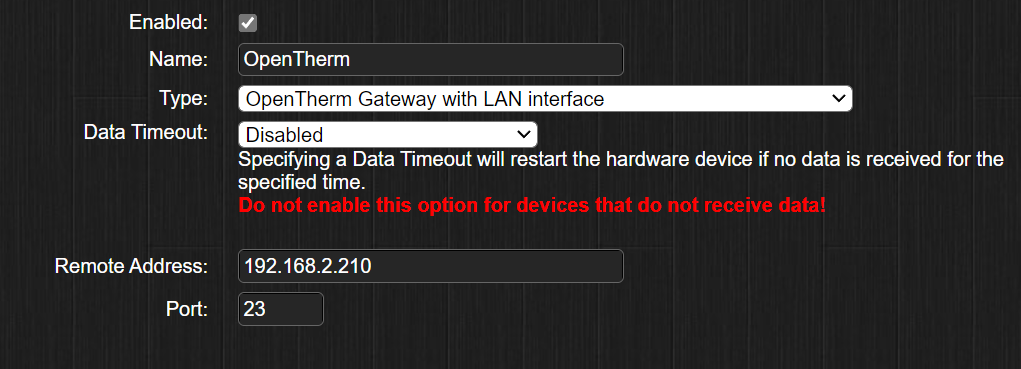

- I allow devices in the domoticz setting.
- there is communication as i do see the log values
