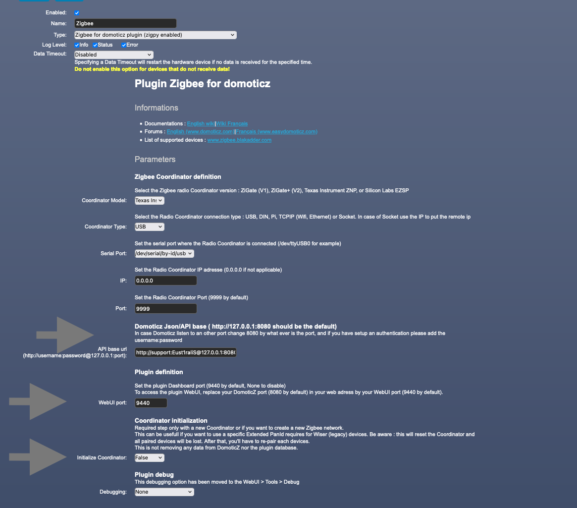

Next to do is to start paring with "Permit join time" and clear old pairings with "Erase Persistent Data: True". But I can't find those settings. Where do I find them?
pipiche
Posts: 2027
Re: IKEA Trådfri button input to blockly event
Post by pipiche »
Hope that helps ...
Post by vfr7 »
Thanx. Ok. It has changed since the instruction was written. Maybe that instruction should also be changed then.
Now, I've probably succeeded emptying the old pairing list with the coordinator initialization.
Then put it in pairing mode. Do you mean that should be done thru the plugin dasboard?
I have tried accessing the dashboard settings by changing port 8080 against 9440 but can't get access to any page there.
