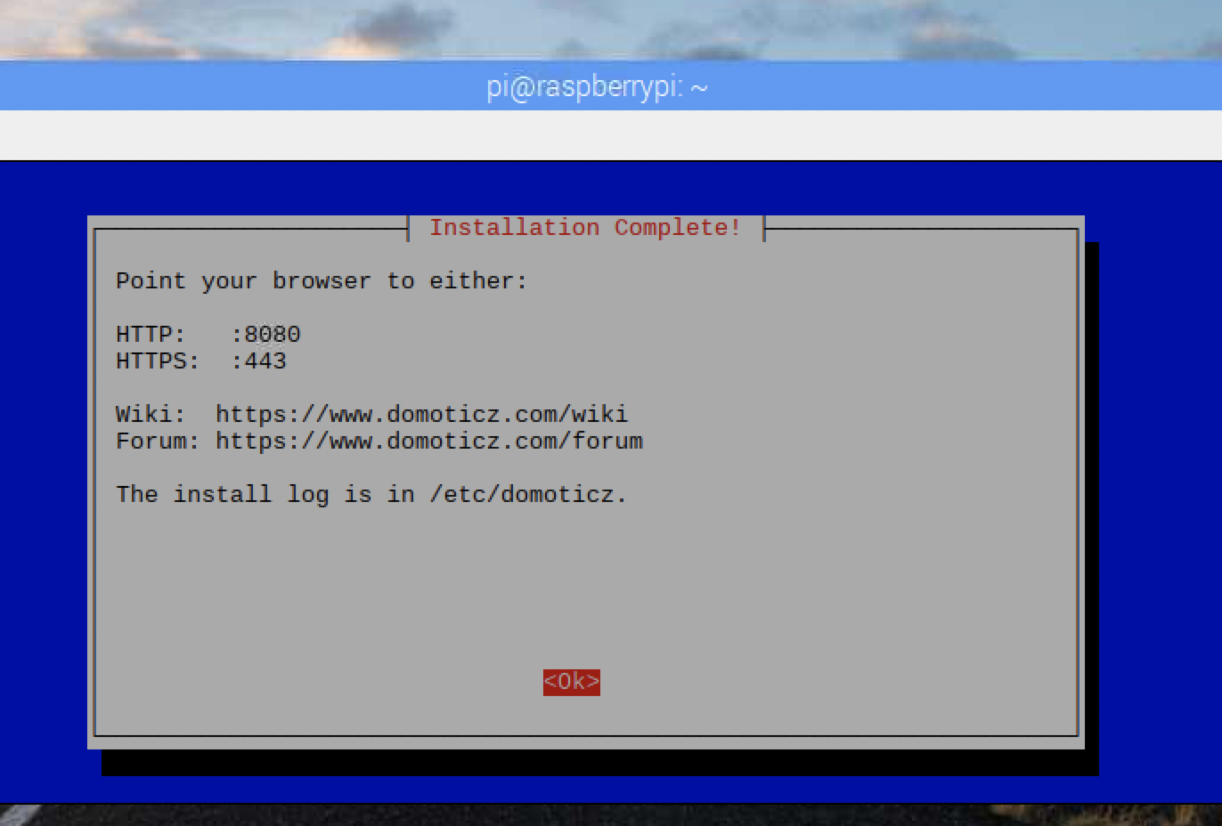

when i install domoticz , i don't get an ip adress. any idea?
The Pi has an working static ip address.
Is there an config file i can change?
- Schermafbeelding 2022-12-26 om 13.51.08.png (389.59 KiB) Viewed 2267 times

According to your screenshot of your domoticz installation is domoticz installed! What is the message when you write http://yourstaticipadress:8080 into Firefox or chrome or edge ......?

1x2 1x8 XX XX refused to connect.sailmich wrote: Tuesday 27 December 2022 11:23 @badair
127 0 0 1 refused to connect.
