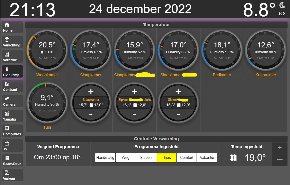

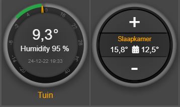

I would like to move the title of a UpDown dial below the dial, because the text is to small to show on my 7"tablet. See images below.
With CSS I can do it for a default dial, but I'm unable to do this for an UpDown dial.
Any suggestions?

madpatrick wrote: Saturday 24 December 2022 19:54 Can you please post the css how you did this
div[class*="screen4"] div[data-id*="temp"] span[class*="device"]{
position: fixed;
font-size: 13px;
top: 125px;
width: 140px;
michelscholte
Posts: 75
Joined: Friday 08 January 2016 10:02
Location: Nederland
Re: Title below UpDown dial
Post by michelscholte »
This is my screen for Temperatuur and CV. It's a lot of CSS config. Unfortunatly I'm unable to move the titles of the UpDown dials underneath the dials.
