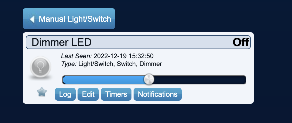

When we have a dimable Led we use the Domoticz Widget with named 'Dimmer'
it looks like recently (maybe linked to the new Blind behaviour) the dimmer do not behave at it was
For instance, when we switch Off , automatic the slider is going to 0, which is not in line with the reallity as you can have a Light Off, but ready to be at 75% of brightness
The here after screen represent what we had we pre-2022.1 version and we don't have any more withe 2022.2, as the slider is going to 0 when switching off the light
Screenshot 2022-12-19 at 16.35.33.png (76.3 KiB) Viewed 225 times

I see the same behavior, but domoticz remembers at what level it was when switched off.
I see this only by the ZfD Python controlled devices (i have no other python plugin controlled dimmers). On a dummy dimmer it keeps the level when switched off.
