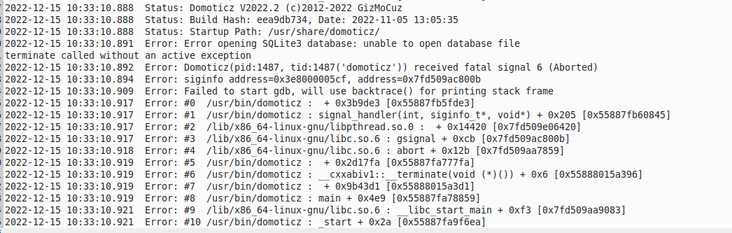

I did install for Openmediavault - Portainer docker container. (latest) Omv is 6.11. Starting fine, after cca 1 minute this error (log file):
Img is attachment...
Not started...
For OMV install, "Error opening SQLite3 database"
- Képernyőkép_2022-12-15_11-56-02.png (102.89 KiB) Viewed 971 times

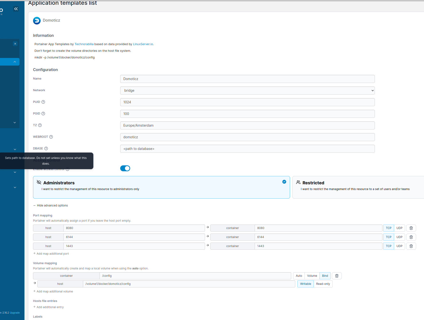

Hi.
I see the link, but I not found "mount" folder (only timezone)..
I have 7 another program in Docker: Plex, MStream (use DB), Homeassistant, torrent, ect.. All perfect.
In OMV6 install full new, no need manually mkdir, create yml file, ect..:
- Képernyőkép_2022-12-16_08-25-15.png (135.67 KiB) Viewed 930 times
