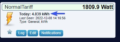

In Lua, I am trying to retrieve the KwH number for a simple cost calculation, but I just can't figure out how to!
If I look at otherdevices_svalues["NormalTariff"], I get 2 values. 1 is the current energy usage, the other is a number that seems to bear no relation to kwh used.
Can someone point me in the right direction? I am assuming I am looking in the wrong place, or the kwh is somehow derived from that second value?
Thanks.

2 is probably total energy consumption while you expect total energy consumption of today.
Maybe you can try using DzEvents.
https://www.domoticz.com/wiki/DzVents:_ ... counter.29

Thanks. The simple lua script did some other things too, but I managed to re-code it in dzvents and retrieve the value with .WhToday
