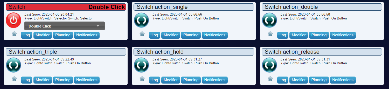

The selector with zigbee2mqtt, I had choice (in red in my picture) and now with Autodiscovery, new pushOn buttons are created. (others buttons on my pictures)
I have the same problem.
- selector.PNG (78.52 KiB) Viewed 1045 times

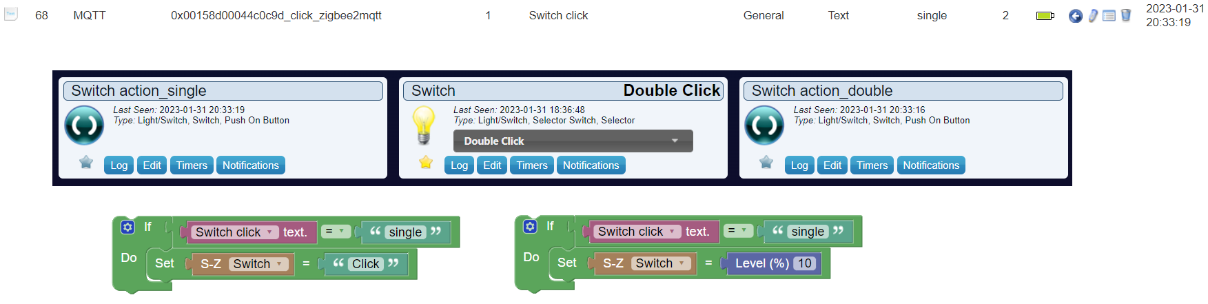

I want to use my Xiaomi Switch to control my home alarm.
One Click to start for exemple and double to stop.
I tried to use event (Blocky), created a Dummy (Switch) and nothing happens.
Do you have a solution ?
- issue_mqtt.png (69.81 KiB) Viewed 1030 times

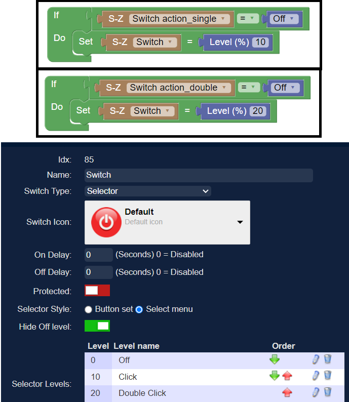

Re: Zigbee Auto Discovery status for selector devices?
I found a solution with a blocky script :
If that could help someone later
