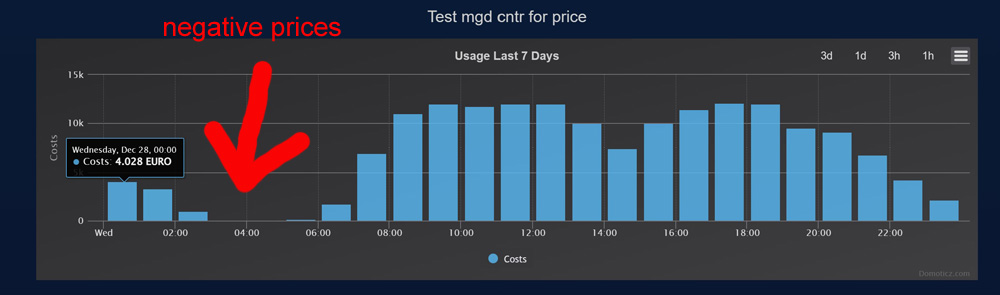

Here is the script updated to load both dynamic electricity prices (change once per hour, published after 15:00 for full next day) and gas prices (change once per day, published after 00:00 for current day and few hours next day) and calculate the costs.
Please adapt for your own country.

I have done a test, just to see whether it is possible to make those future prices visible in a domoticz graph. Result positive, except for negative prices (as expected). Tomorrow there are 2 hours with negative price, so a good test !!!
What I did:
1) create a managed counter device of type costs, with unit euro.
2) copied my script above and stripped it from all functionality except the part to import the ENTSOE day ahead prices.
3) added an updateHistory() statement to it in order to load every price *100 onto the managed counter with a timestamp into the future (this results in an entry in the meter table).
4) checked the meter table and checked the graph of the device.
Conclusion is that it is possible to load tomorrow's prices onto the device with a future timestamp. It does result in entries in the meter table with a future timestamp and it does result in a graph showing the prices for the day. The only limitation is that negative prices cannot be loaded and shown. Negative prices result in zero. This is a known limitation of managed counters. Also note if you run the script for a second time with the same timestamp then the existing values get replaced (which is nice).
Also note you need to exclude the managed counter from the domoticz daily closing by adding "DisableLogAutoUpdate:dHJ1ZQ==" into the options field of the devicestatus table, for example using sqlite3. (see https://www.domoticz.com/wiki/Domoticz_ ... n_counters)
Since this was just a quick test, my script is a bit dirty:
1) I hardcoaded the timestamp.
2) I multiplied the prices by 100 in order not to loose the decimals, so the unit is now EURO per 100 MWh.
but as a proof-of-principle it works.
Here is the graph:
Here is the script:

and here are the entries from the meter table (created on the 27th):
112|0|0|2022-12-28 00:00:00
112|4028|4028|2022-12-28 01:00:00
112|3313|3313|2022-12-28 02:00:00
112|983|983|2022-12-28 03:00:00
112|0|0|2022-12-28 04:00:00
112|0|0|2022-12-28 05:00:00
112|78|78|2022-12-28 06:00:00
112|1729|1729|2022-12-28 07:00:00
112|6985|6985|2022-12-28 08:00:00
112|11000|11000|2022-12-28 09:00:00
112|12000|12000|2022-12-28 10:00:00
112|11800|11800|2022-12-28 11:00:00
112|12000|12000|2022-12-28 12:00:00
112|12000|12000|2022-12-28 13:00:00
112|10000|10000|2022-12-28 14:00:00
112|7490|7490|2022-12-28 15:00:00
112|10000|10000|2022-12-28 16:00:00
112|11426|11426|2022-12-28 17:00:00
112|12126|12126|2022-12-28 18:00:00
112|11990|11990|2022-12-28 19:00:00
112|9514|9514|2022-12-28 20:00:00
112|9135|9135|2022-12-28 21:00:00
112|6818|6818|2022-12-28 22:00:00
112|4254|4254|2022-12-28 23:00:00

Nicely done. Personally, I don't find the future prices in a graph that interesting: you actually want to determine what favorable hours are to switch on and/or charge devices based on these future values. If you look at such a graph, it is quite logical which times are best suited for this, but it is still quite difficult to convert that into an algorithm. Does anyone already have experience with that?
willemd
Posts: 737
Domoticz version: 2024.1
Re: script to load ENTSOE day ahead electricity prices
Post by willemd »
JanvdW wrote: Tuesday 27 December 2022 23:13 Nicely done. Personally, I don't find the future prices in a graph that interesting: you actually want to determine what favorable hours are to switch on and/or charge devices based on these future values. If you look at such a graph, it is quite logical which times are best suited for this, but it is still quite difficult to convert that into an algorithm. Does anyone already have experience with that?
Yes, it is a nice challenge:
1) First you need to know some basic variables: the total charge/discharge capacity and the charge/discharge time needed, in case of batteries.
2) You want to take a minimum for charge and maximum for discharge, maybe with extra hours before or after, depending on the charge/discharge time (if it takes more than 1 hour)
3) You want to do that multiple times per day if possible.
4) You might want to take next days data into account as soon as that is published.
In the example graph above:
1) charge the battery when prices are negative between 03:00 and 05:00. You get paid to get electricity from the grid.
2) then discharge from 9:00 to 10:00
3) charge again from 10:00 to 11:00? is it worth it? and then discharge again between 11:00 and 13:00
4) charge again from 14:00 to 15:00
5) discharge again from 17:00 to 18:00
6) even if the value is low, you probably don't want to charge already at 23:00 since probably the price goes down further the next morning. Note next day's prices are published at 15:00.
Key to a good solution is to find the local minimum and maximum prices. I think probably by checking its neighbours. Neighbours should both be higher, in case of minimum, or lower, in case of maximum. In the example you would find 3 minimum values, a 3 maximum values.
This will provide you with the pairs for charging and discharging. So, if you can charge/discharge full capacity within 1 hour it is not too difficult.
But if it takes more than 1 hour...how to optimise ... need to think about it more. Feels like a recursive algorithm might do the trick here.
