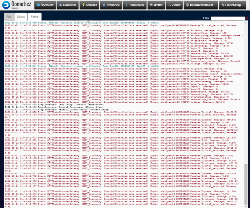

Hi All,
I try to use the mqtt auto discovery Plugin also, but there I got very much Error Messages.
Anyone with Idea here?
Errormessages like this:
022-11-21 20:17:55.793 Error: Shellie3EMHauptstrom: (ShellyCloudPlugin) failed to load 'plugin.py', Python Path used was '/home/pi/domoticz/plugins/ShellyCloudPlugin/:/usr/lib/python37.zip:/usr/lib/python3.7:/usr/lib/python3.7/lib-dynload:/usr/local/lib/python3.7/dist-packages:/usr/lib/python3/dist-packages:/usr/lib/python3.7/dist-packages'.
2022-11-21 20:17:55.793 Error: Shellie3EMHauptstrom: Module Import failed, exception: 'ModuleNotFoundError'
2022-11-21 20:17:55.793 Error: Shellie3EMHauptstrom: Module Import failed: ' Name: requests'
2022-11-21 20:17:55.793 Error: Shellie3EMHauptstrom: Error Line details not available.
2022-11-21 20:17:55.793 Error: Shellie3EMHauptstrom: Exception traceback:
2022-11-21 20:17:55.793 Error: Shellie3EMHauptstrom: ----> Line 50 in '/home/pi/domoticz/plugins/ShellyCloudPlugin/plugin.py', function <module>
and this:

Shelly does not support the mqtt Autodiscover protocol so you can forget this.
For the plugin it is missing the python module requests. You need to install this. if you already did it, install it again but then with sudo.
