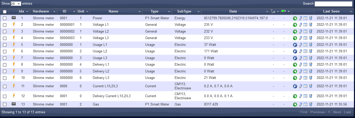

After adding the P1 Smart Meter USB the following devices are shown in the devices overview:
This overview shows the usage data is only available per phase while the wiki page https://www.domoticz.com/wiki/Dutch_DSM ... th_P1_port suggests there should also be a "Total Electricity Usage" sensor. How to get the usage for the three phases combined?

That is the top one, named Power.
You have to activate it (click on the green arow).

Please give it a try and you will see.
It is a P1 Smart meter device, it will show:
Total Electricity Usage (Current usage (W), Daily usage (kWh) and Total usage (kWh), idem Return values
When you click on the log button you will see the graphs. When you click in the log on the report button you will see the values and graphs per month and year.
