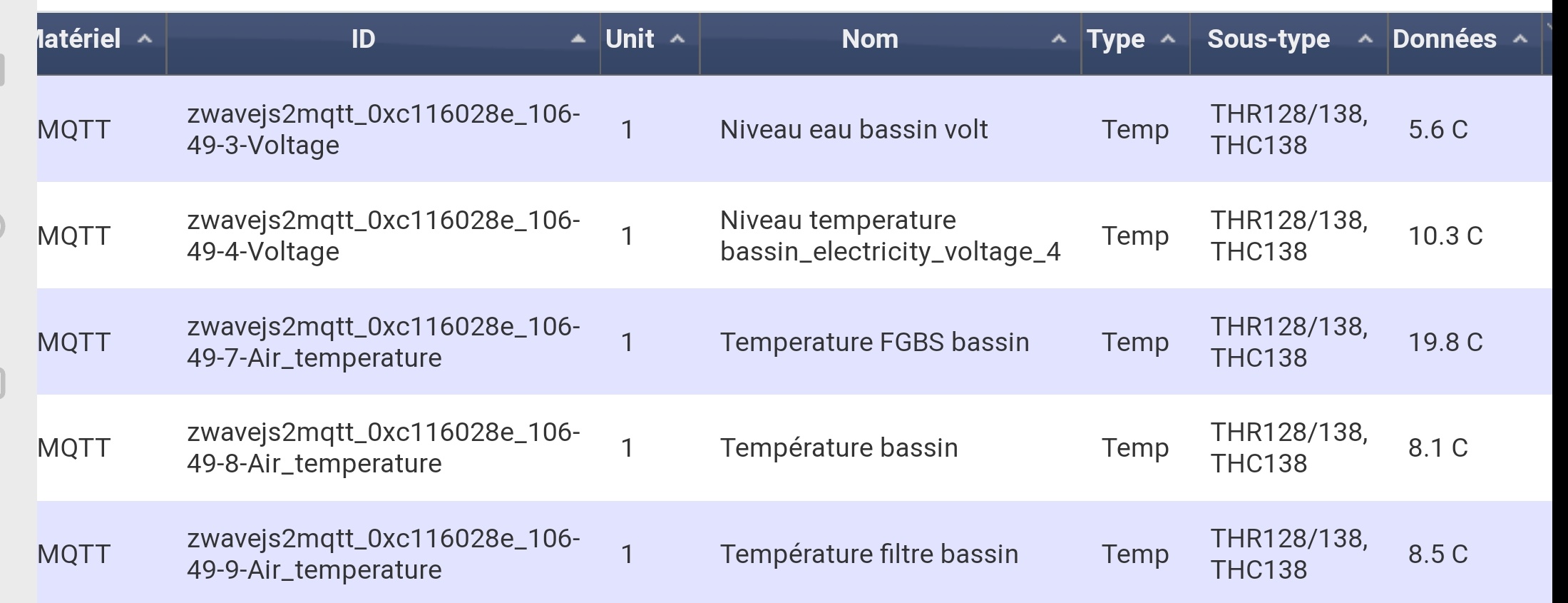

I have little problem, with the volt devices on a FGBS 222, they are in degrees instead of volts.
I have already try to erase the devices and re-add to them on domoticz but they come back in degrees.

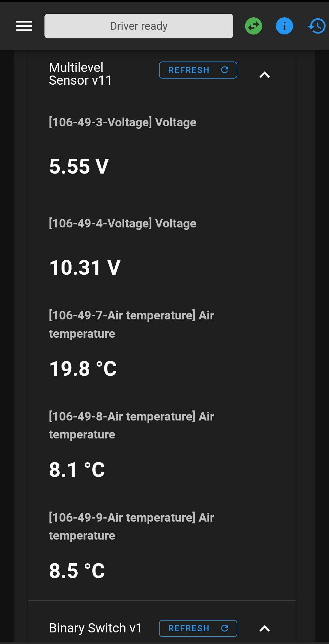

They are in volt into zwave JS UI...
Firmware 5.2 of the fbgs, I have an other one with the firmware 5.1 it work without problem
Is it possible to convert a device from temperature to voltage?!
It's not a big problem because I use this value to calculate a level in cm but I would like to have all the decimals to be more precise
