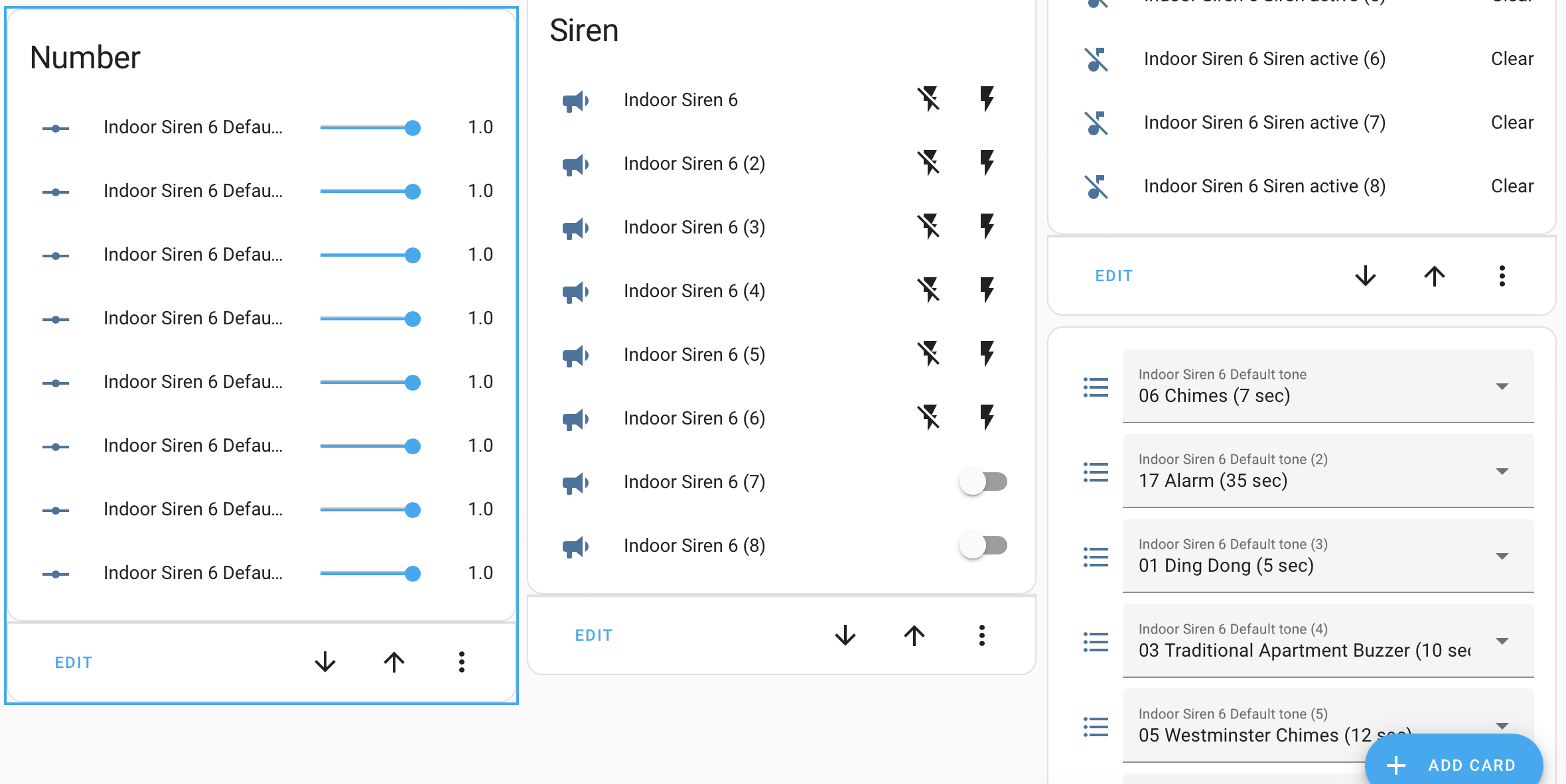

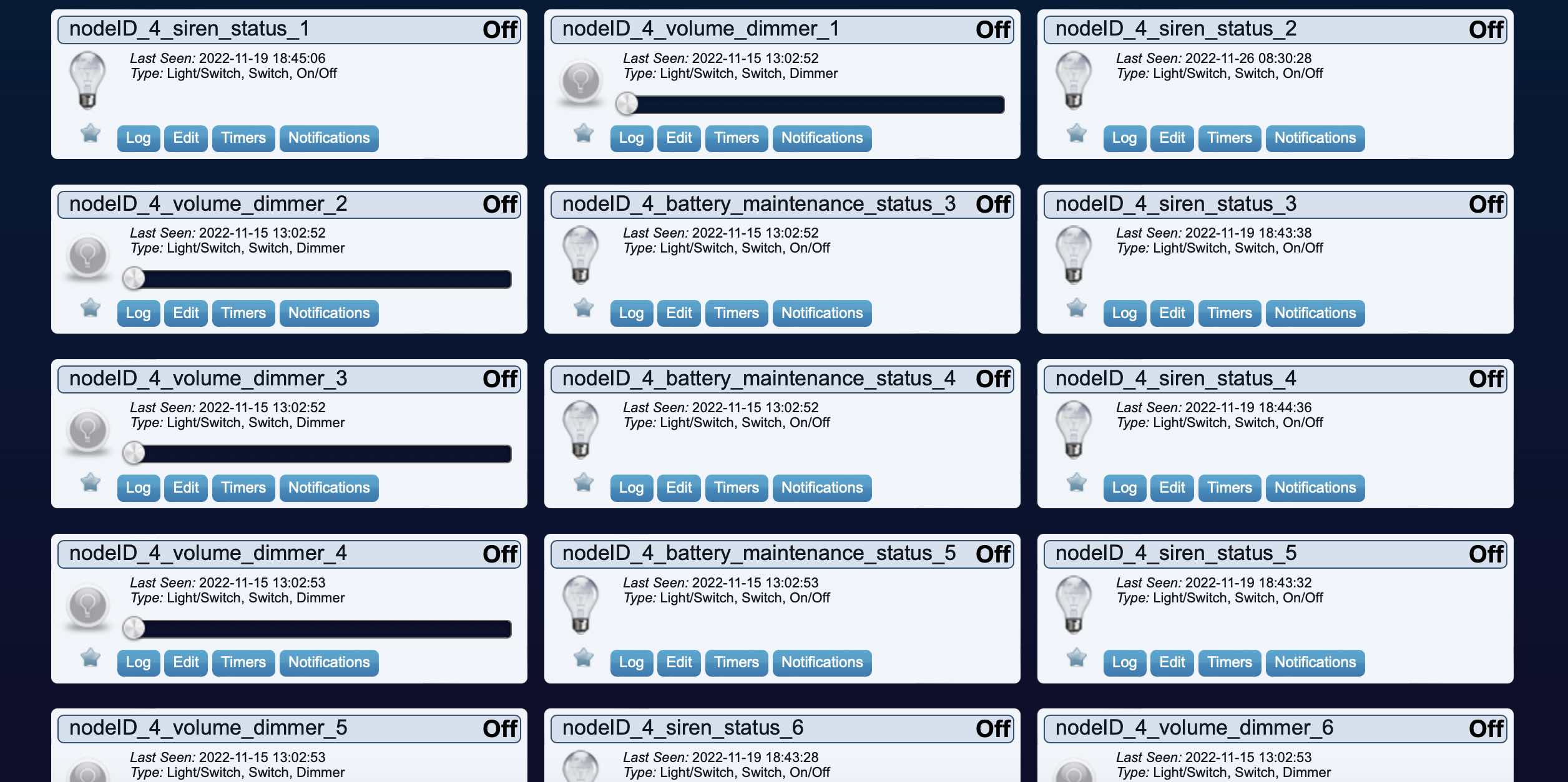

For what it is worth:
- I migrated a test pi to Z-Wave js ui instead of OZW
- With MQTT autodiscovery Domoticz found a series of devices: volume sliders for each endpoint and binary sensor for each endpoint. However no devices to switch the siren endpoint on or off.
- I connected Home Assistant to the same zwave js ui instance and through the direct interface to HA from zwave js ui a lot more devices were discovered. For each end point a volume sliders, a binary sensor, an on/off switch, and a device that let's you select the tune to play when the end point gets activated.
Not sure (yet) why Domoticz autodiscovery does not add the same set of devices that HA does. Spinning up a docker with HA for just the siren 6 could of course work but is quite some overhead. You could use Domoticz<>HA integration though to set the endpoint tone and volume.
HA and domoticz screenshots below:

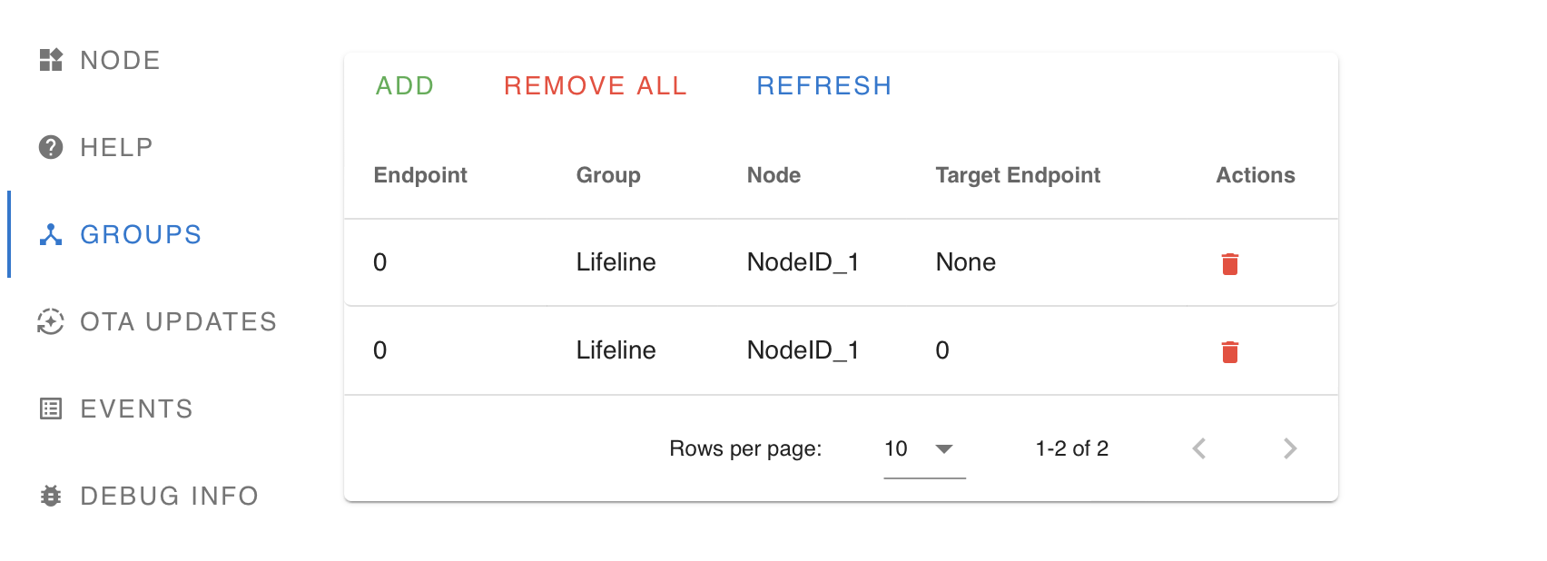

To also answer the initial question on setting endpoints in groups, I suspect (but not tested) that zwave js ui supports this:
Maybe it would also work to just change the sound for the 1st endpoint with HA?
