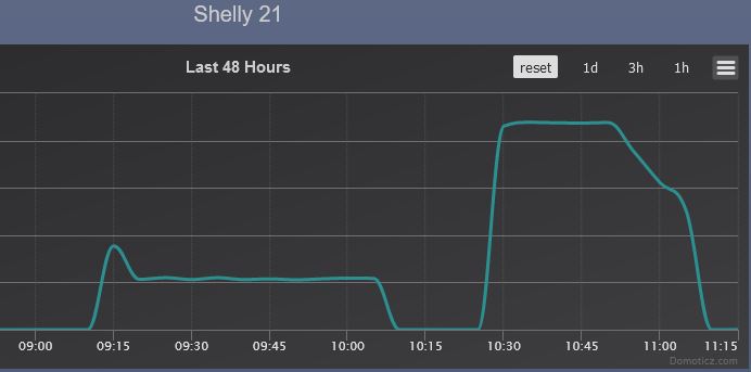

What you see is a charging diagram for charging a battery.
On the left side charging starts, it is switched off for a while, then charging continues and on the right side you see the # of Watts drop.
I want to use this phenomenon to protect the battery from being charged to 100% (which leads to a longer battery life)
So I want to measure Watt every minute and compare the current Watt with the Watt of let's say 10 minutes before.
If the Wattage dropped by 10% compared to 10 minutes before domoticz can switch off the switch which powers the charging. (this switch maybe a relay or a Shelly or whatever)

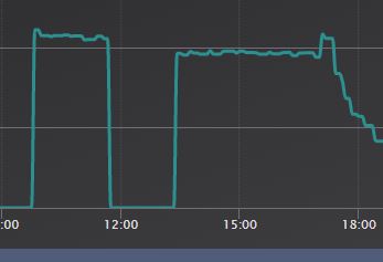

Some devices start with high charging rates and these rates drop after a short while.
To prevent inadverted switching off the code eliminates the first data and starts regulating after 3 minutes.
For testing purposes I started with capturing 10 minutes of data.
The code works fine with 8 minutes interval for testing.
Superfluous lines can be deleted.
The time span for comparision and sensibility can be set with this part of the code.
                if domoticz.data.value_8 > 1.33 * domoticz.data.value_0 then
                    -- switch off shelly like switchoff Groene lampjes
                    domoticz.devices(CHARGER_SWITCH).switchOff()

Left line is a device that starts with a high value that drops, right line is a device that charges with a continuous level.

It stops charging somewhere between 85 and 95%
