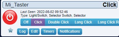

My ceiling fan can be remote controlled using a 433 Mhz. The 433 Mhz transreceiver, which is attached to Domoticz, was able to learn and replicate the signals. So for testing I created a virtual button to turn on the fan. But the fan has 9 buttons and therefore same number of options available. I do not necessarily want to create 9 buttons for just one device.
Looking at other devices I have such as Xiaomi button or Shelly Button, it looks like that one button supports multiple actions. So I am wondering how I can create one button for my ceiling fan and create up to 9 functions / actions as shown in the screenshot attached but like (1 | 2 | 3 | Light | OFF ...)

Are you asking how to create a virtual Selector Switch?
An example see here: https://forum.mysensors.org/topic/4933/ ... z-tutorial
This is quite simple, but you provided insufficient information on what this Selector Switch (the various buttons) should do.

That tutorial does the trick, thank you very much!FireWizard wrote: Thursday 04 August 2022 21:11 Hello @ChrisVH1982,
