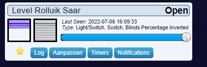

I recently installed a Fibaro Walli Roller Shutter to my roller shutter :) . That all went nicely. The hardware is functioning. But I would like to controle my roller shutter from Domoticz.
I included the Roller Shutter via domoticz via "include node secure" That all went well. Then I added the device as a Switch.
I then change the switch type to "Blinds Percentage Inverted"
The roller shutter is opening, closing en stopping when I push the buttons.
Domoticz wil refresh the info on the switch. But I can't change it from Domoticz. I would like to close the shutter via Domoticz or change the percentage of open.

I found the solution. I included the Walli via Domoticz. I used "include node secure". This morning I excluded the sensor en included it with my Aeotec 5thGen+ Zwave stick. Now i can control the Walli from Domoticz like i wanted to.
