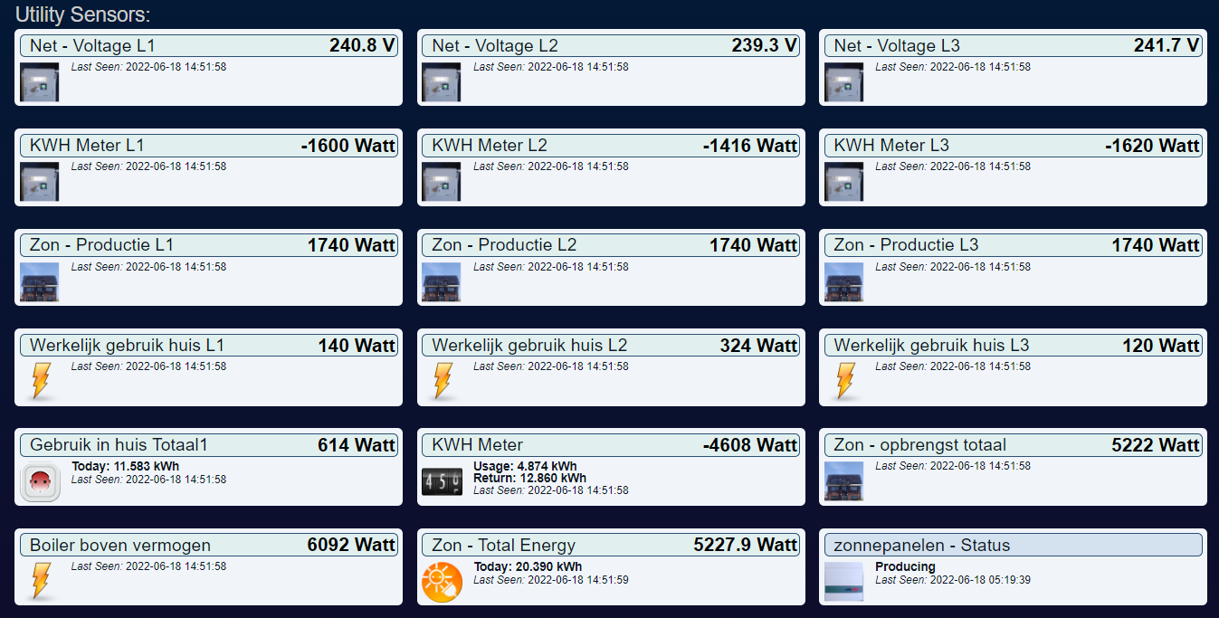

Thank you all for responding, let me try to clarify.
In the 2022.1 version I have the three phases for both usages and return, right?
So in a script I can do the calculation of the nett result:
nett_energy_usage_result = (0 - ( p1usagel1+ p1usagel2+ p1usagel3)) + p1deliveryl1 + p1deliveryl2 + p1deliveryl3
This provides the TOTAL actual value at that point in time (in kW).
However you may paying for electricity on L2 and L3, where - at the same time - L1 has a return (you are receiving money).
So I'd like to see per Line how does it look per day? Is the energy returned and used (per line) evenly distributed?
Or do I have an unbalanced situation where once the netting (Dutch: saldering) is gone, I may be shocked that I am going to pay so much more, since I am not using any energy produced by the Solar Panel.
Ps. I do have an 'Electricity' background. My example was to paint a picture that people can relate to. I do have a 3phase solar panel convertor
I think 99% of people don't realise what the impact will be to have a 1phase convertor on a Line which does not have a (lot of) load (=devices) on it.
And at this point in time I can not see this info myself (and I don't want to learn or build a Grafana setup)

Since a longer time, in case of a 3-phase smart meter we have available 3 sensors for Power Consumption and also 3 sensors for Power Delivery.In the 2022.1 version I have the three phases for both usages and return, right?
One for each phase. So that is correct.
That is correct, but is already done by Domoticz in the P1 Smart Meter sensor. A positive value, if you consume power from the grid and a negative value, if you deliver power to the grid. So no need to calculate it again.So in a script I can do the calculation of the nett result:
I understand your concern, but there is nothing to worry about, as the smart meter makes its own calculation and your are not paying for the power you use for L2 and L3 and receive money back for L1.However you may paying for electricity on L2 and L3, where - at the same time - L1 has a return (you are receiving money).
Example:
Imagine that you deliver 3kW to the grid on L1 and you consume 1kW from L2 and also 1kW from L3
This does not mean that you pay your price for L2 and L3 consumption and get paid (in the future less than you pay for consumption) for L1.
It means that the smart meter calculates internally that you deliver 1kW to the grid (3-1-1) and you get paid for that.
This is not very well documented on the Internet and very difficult to find.
I found something in Dutch at: https://www.coolblue.nl/zonnepanelen/ad ... imme-meter
This 100% return compensation exists only in the Netherlands at the moment. There are even countries, that don't pay anything for returned power.
You always will, as long as the sun shinesSo I'd like to see per Line how does it look per day? Is the energy returned and used (per line) evenly distributed?
Nothing, as you could have read.I think 99% of people don't realise what the impact will be to have a 1phase convertor on a Line which does not have a (lot of) load (=devices) on it.

For the enhancements, here are mine, P1 port plus solardata: Very satisfying to watch updates every 10 seconds, sometimes things calculate wrong but that is fine with me..

I do like your overview from the P1 meter! Did you use any scripts or are these common available objects from the P1 meter?

Its all scripted, to compute the values and to make the values after comma dissapear(I don't like decimals like with the 'Zon - total energy' one)
example: to calculate home usage F1(Werkelijk gebruik huis L1) = KWH meter F1 + solar F1)

Thanks,I do like your overview from the P1 meter! Did you use any scripts
