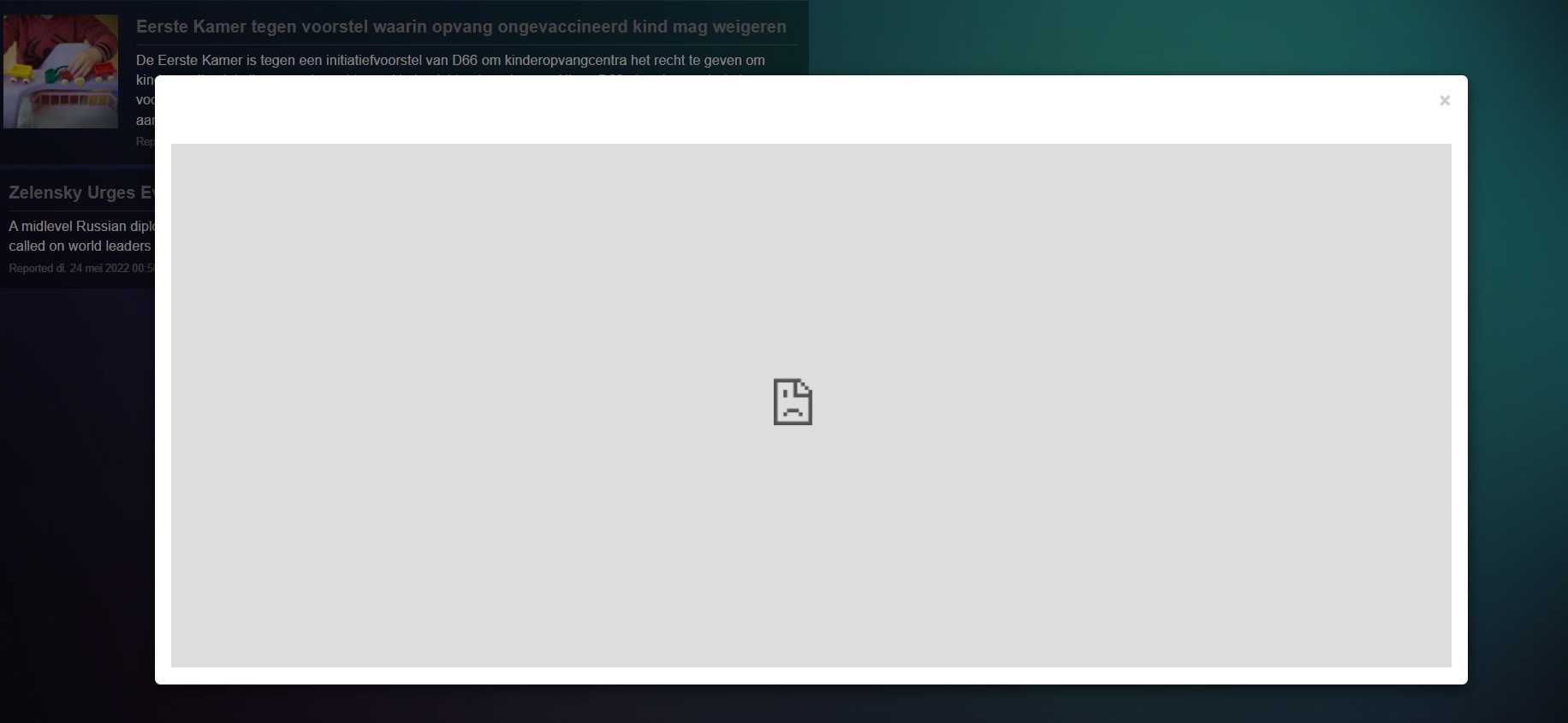

Does anyone know a good news feed (rrs) that works with dashticz.
i tried the rss feed from nu.nl, tweakers, NOS, BBC, newyork time, etc and none of them allow a popup to read the artikel.
or am i doing something wrong?
if a popup to read the artikel is never allowed at all, the function of the rss feed is useless in dashticz.
RSS feed that allow popup Topic is solved

- newsfeed.jpg (66.71 KiB) Viewed 881 times

Currently most sites block displaying content in a popup window (iframe).
You can display the newsarticle in a separate browser tab by setting the newwindow block parameter. Example:
blocks['newsnunl'] = {
feed: 'https://www.nu.nl/rss/Algemeen',
maxheight: 220,
newwindow:1

Re: RSS feed that allow popup
oke thanks, i will try if that works
but the strange thing is that if nu.nl shows a rss artikel on my dashboard with a video in it, it works and if its is only tekst the popup doesn't work...
