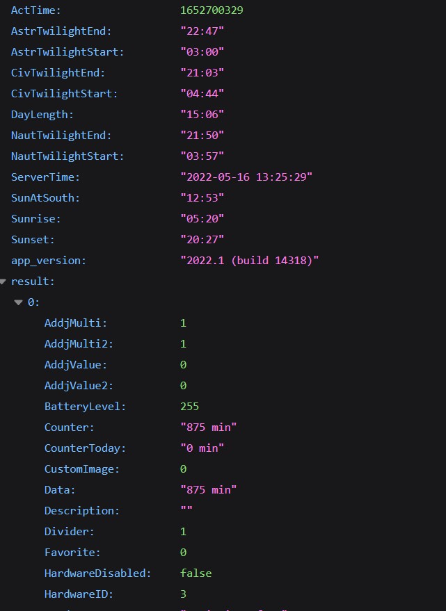

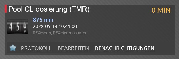

I want to use "x.counterToday" in dzvents to display the actual daily runtime of a device in an external system.
		timer = {
			'every minute',
		logging = {
        level = domoticz.LOG_INFO,
        marker = "TMR"
	execute = function(domoticz, timer)
		domoticz.log('CL dosierung (TMR): '..domoticz.devices('$Pool CL dosierung (TMR)').counterToday, domoticz.LOG_INFO)
In the Webinterface and the Json output display the Value "0" but dzvents diplays the last value from yesterday until a new value is set.
Does someone know where the bug is ?

I can confirm that behavior. I have two counters (solarpanel generation) that I summarize in a total counter. And I see that one of these solarpanel counters is reset only when a new value is written to the counter, normally the next morning after sunrise. The other counter is reset at midnight. probably by the plugin that is controlling it.
