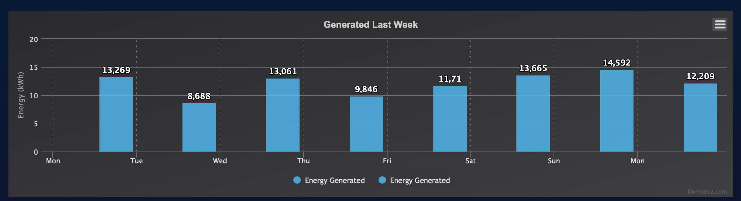

I have a couple of virtual devices, type Electric (Instant + Counter). I feed current counter values to these devices through a nodered flow. I noticed that the Generated Last Week chart shows the "Energy generated" data series twice.
Generated last month and Generated last year charts are all fine.
Any ideas on how to remove the empty data series?
Cheers, Friso
Energy generated appears twice in chart

Re: Energy generated appears twice in chart
@friso82,
I can confirm, it is there.
I have seen this for a longer time and it still does show in the latest beta. However as it is only the legend, I did not put much attention to it.
I do not believe it is a bug. If you configure the widget as "Usage" instead of "Return" you will get 2 bars with the text Energy Usage, instead of Energy Generated. I think, but I'm not sure, as I do not have such a device, that they will represent Tariff 1, resp. Tariff 2. For generated energy Tariff 1 will be missing of course, except in the weekend, when Tariff 2 should be missing. But I do not see that bar.
So for the moment, I suggest, that you click on the left text (Energy Generated) and it will disappear.
Unless someone has another explanation.

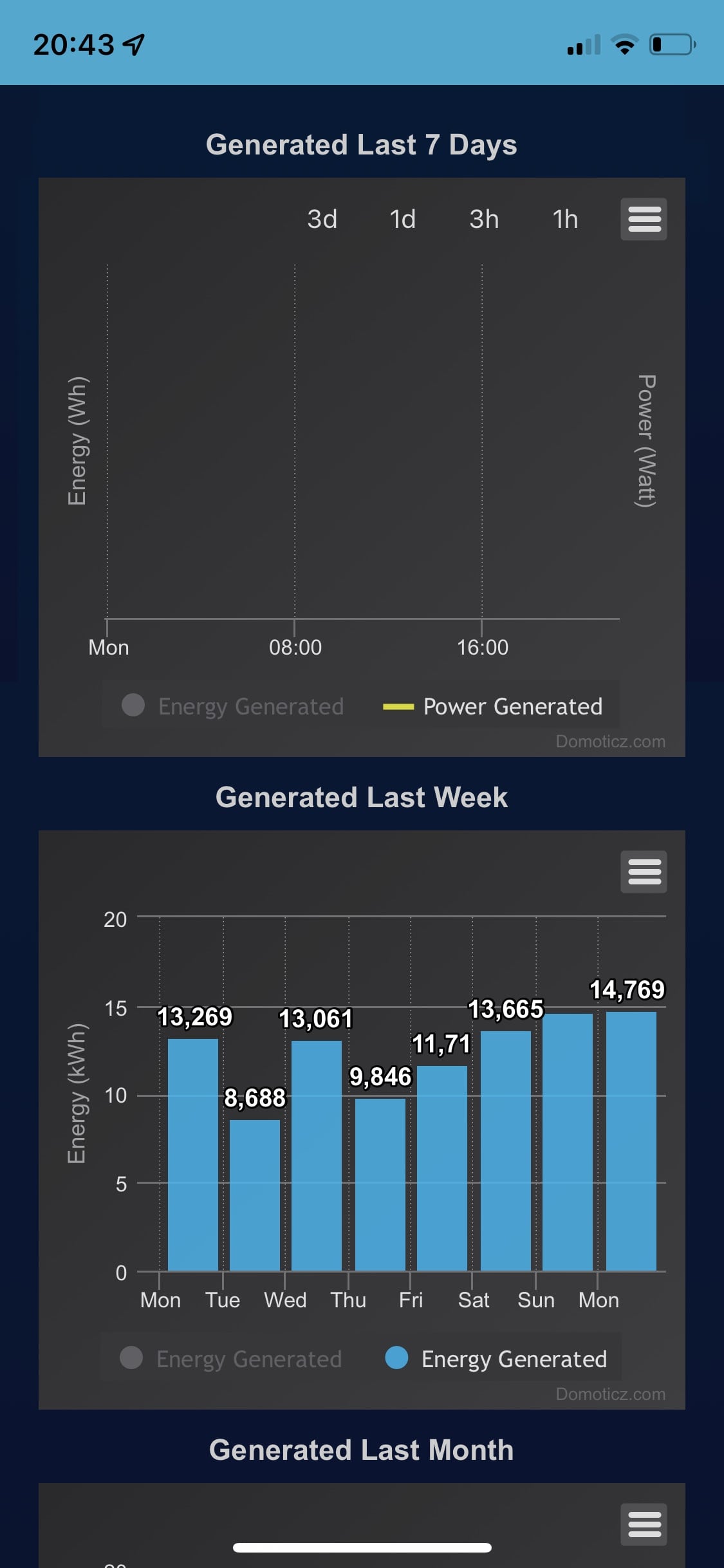

Hi @FireWizard,
Thanks for your reply. I think it has something to do with the fact that the first chart also shows power generation. When I turn off the left Energy generated legend item and refresh the page, the "energy generated" legend in the first chart is also gone and the first chart is not showing anything.
This issue has been solved somewhere in the latest betas. I noticed that the charts display correct now. Running build 15182
