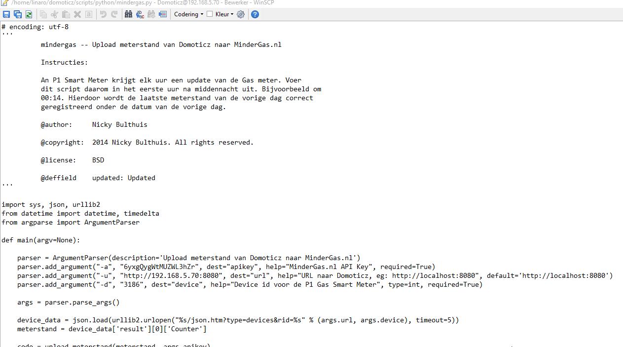

dear all..
I will try to use the phyton way..
install phyton.
make the script
make the crontab..
Is there a way to test. this option?
Because it is not working...
Derik
Posts: 1605
Re: Posting data once a day to Mindergas.nl
Post by Derik »
Should i perhaps remove the http://?
