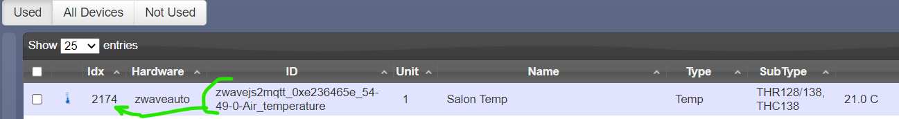

Is there any direct way to get the Hardware ID for MQTT Discovery devices with DzVents in order to get the idx (I didn't find the field in DzVents)
Screenshot 2022-04-02 092007.png (31.59 KiB) Viewed 1163 times
I'm currently do it by SQL but maybe not the best way...
The use case is to get the Idx from the MQTT topic (zwavejs2mqtt -> mqtt -> NodeRED -> MQTT -> Dz)
I'm doing this

Yes, it is the field.
My purpose is to get the idx (1975) from the ID (zwavejs2mqtt_0xe236465e_11-37-0-currentValue), not the reverse...
