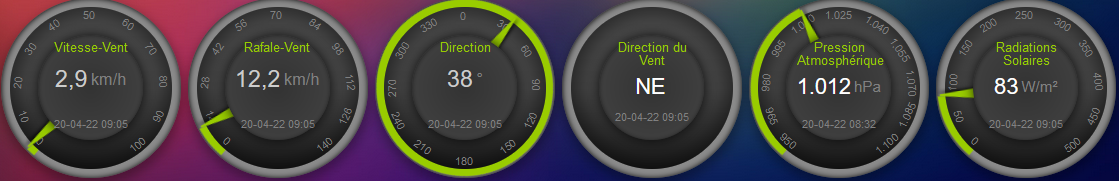

My problem
The color of the ring dial
Why the 'Direction' ring is white (idem "Vitesse-Vent" et "Direction-Vent")
Why are the 'Rain/...' rings not the same thickness as 'Pressure or Radiation'?
My CONFIG.js

Lokonli
Posts: 2290
Re: Dashticz - Dial Ring Color
Post by Lokonli »
Doudy wrote: Wednesday 13 April 2022 8:29 Nobody ?
When I use your block definition for 'wind3' (='Direction') and your custom.css then the ring color of my dial becomes green (#99CC00)
So I think there is some other code probably in your custom.css that gives the white color of the ring. Or another setting in CONFIG.js
To debug, start with an empty CONFIG.js and an empty custom.css.
Then add your 'direction' block to CONFIG.js and check how it looks.
Looking at your custom.css, I think you made a small mistake.
Instead of:
[data-id='wind1']  .slice.primary, .secondary {color: #99cc00 !important;}
probably you mean the following:
[data-id='wind1']  .slice.primary, [data-id='wind1']  .slice.secondary {color: #99cc00 !important;}
(you have to repeat the complete css selector when you use a comma)
But, in fact the custom.css coloring is not needed, since you're already using the 'color' parameter in your block definition:
	color: '#99cc00',
This will already give a green ring color, and a green title.
edit:
You may have to add the following block parameter:
    setpoint: -1
The setpoint for a wind device is 15 by default, which is not logical for a wind direction dial.
(if the wind direction < 15 the ring will get the 'secondary' color)

I have change "wind3" :
blocks['wind3'] = {
	idx: 43,
	title: 'Direction ',  // Direction du vent °
	type: 'dial',
	color: '#99cc00',
	width: 2,
	values: [],
	setpoint: -1,
	showring: true,
	showunit: true,
	shownumbers: true,
	last_update: true,
	showvalue: true,
and CSS :
[data-id='wind3']  .slice.primary, [data-id='wind3']  .slice.secondary {color: #99cc00 !important;}
but i have green color at the full ring !
the other wind rings are OK
I have no oder code with wind3!
That is correct, by design.
What would you prefer?

Only green up to the number of degrees indicated
Lokonli
Posts: 2290
Post by Lokonli »
Doudy wrote:Hello,
And 330? As an almost complete ring, or like -30 starting from top?
