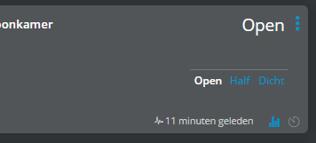

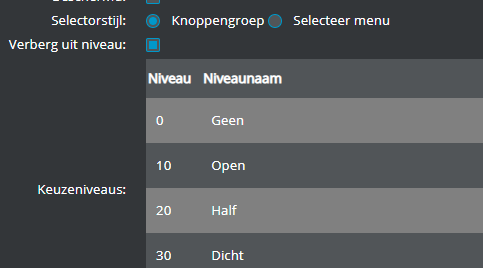

- madpatrick
- Posts: 885
- Joined: Monday 26 December 2016 12:17
- Domoticz version: 2026.1
Re: Dashticz dial
Hi Lokonli
I noticed that the hidden Off level is show on the dial
You have the option with a selecto to hide the Off level (first option). This is then hidden in Domoticz, but not in my Dial selector
