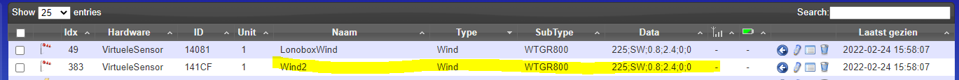

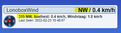

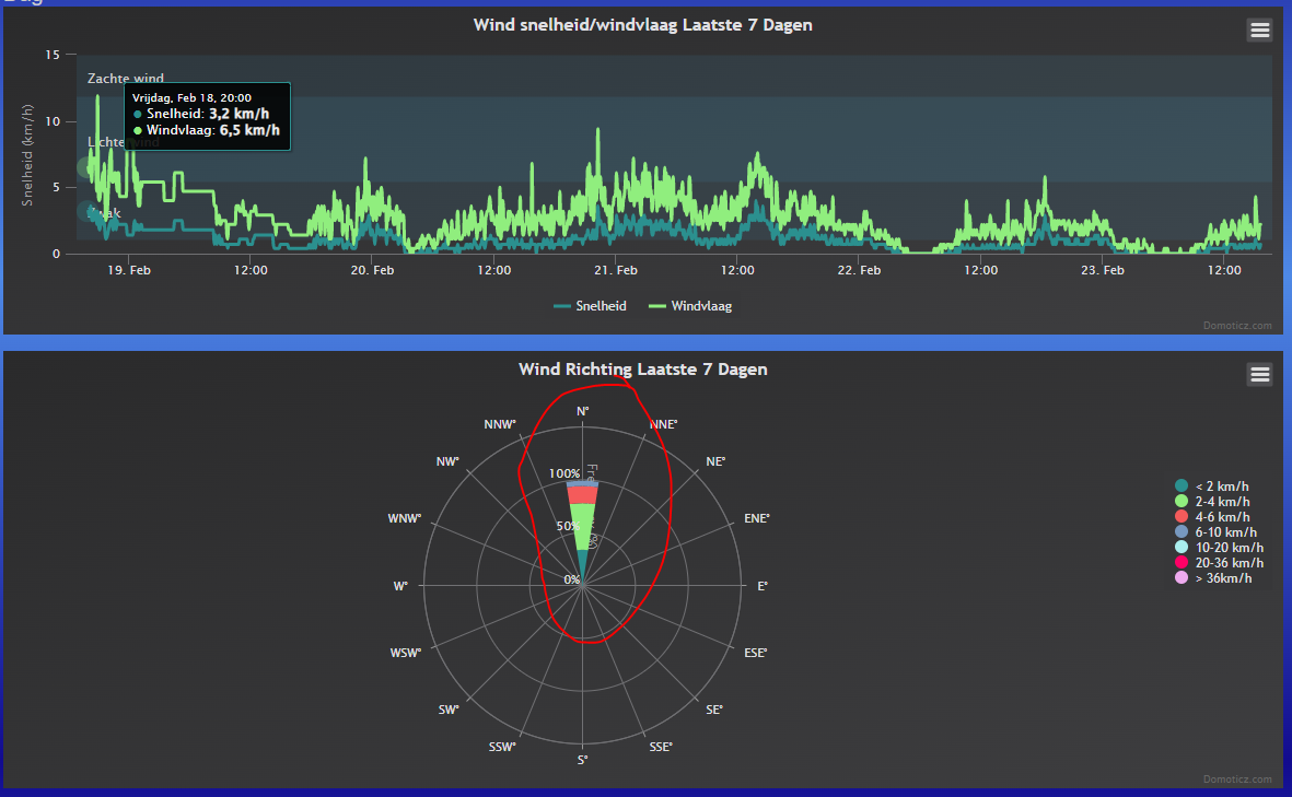

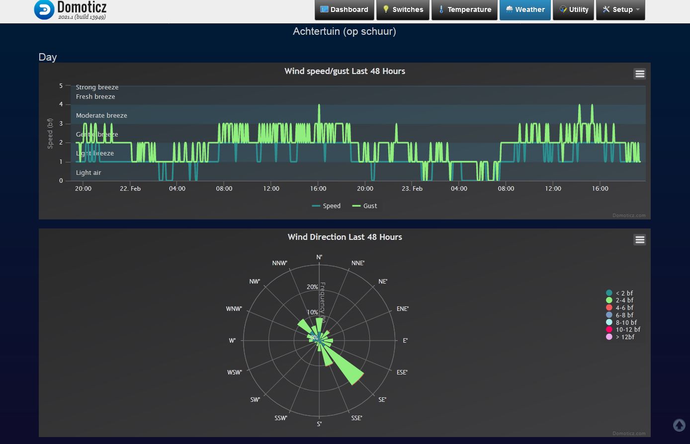

Hello everyone,
I have been using Domoticz for years with great satisfaction.
However, what I never got going is the wind direction on the logging page.
This while the wind direction is properly communicated via a virtual sensor.
see pictures for clarification.
What do I need to change to get this right?
Thanks in advance for your directions.

What exactly are you feeding to the virtual (dummy) device for possible wind directions?FonsBrand wrote: Wednesday 23 February 2022 15:55 However, what I never got going is the wind direction on the logging page.
Edit: Actually that data looks a little odd in the capture: 315;NW;1;5.2;;)

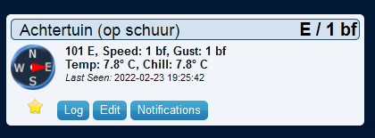

This is how my wind data comes in, perhaps it is helpful to you
(My wind-meter has also a additional temperature sensor)

Ok... and that one looks good .... so where is this virtual device filled that isn't working correctly? A script?
.. and did you see my last statement in my previous post?

I see that there is one ) too many.jvdz wrote: Wednesday 23 February 2022 16:45What exactly are you feeding to the virtual (dummy) device for possible wind directions?FonsBrand wrote: Wednesday 23 February 2022 15:55 However, what I never got going is the wind direction on the logging page.
Edit: Actually that data looks a little odd in the capture: 315;NW;1;5.2;)
Corrected and that doesn't help. Also the empty places filled with 0 and this also does not solve the problem.

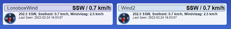

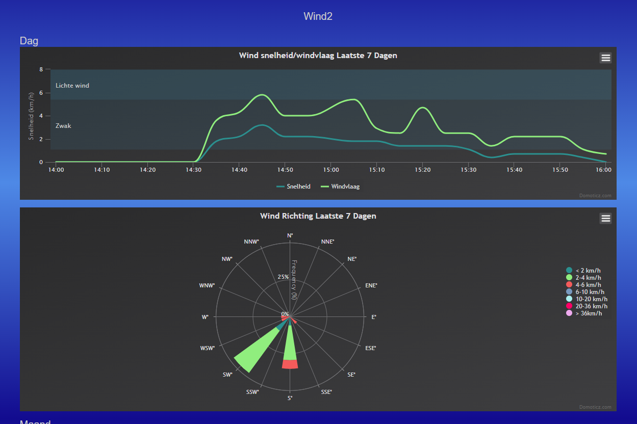

I have created a new virtual sensor and I fill it with the same script and now it works miraculously.jvdz wrote: Thursday 24 February 2022 14:43 Can you share the script so we can have a look and possible test?![]()
- log nieuwe sensor
- Wind loging3.PNG (182.67 KiB) Viewed 856 times
- nieuwe virtual sensor
- virtual sensor2.PNG (22.44 KiB) Viewed 856 times
