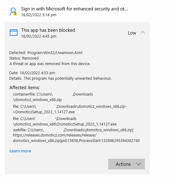

Agreed I had the same result installing Domoticz latest stable from here https://releases.domoticz.com/releases/ ... ws_x86.zip on Windows 10.
Windows Security detected Trojan Program:Win32/Uwamson.A!ml
Please view attached screenshot
Many thanks
m
Many thanks

The installer does not contain any Virus or Trojan but does contain a application (NSSM) that can turn Domoticz into a Windows service so it can run in the background.
This application is from 2017 and never had any issues until recently ... still unknown why because it is used a lot
I have found an alternative that I have checked on various online scanning websites and this one does not yet give any issues
https://github.com/winsw/winsw
I will try to find some time today to make a new installer with this today (or very near feature)
Until then, don't stress !

Thanks for the reply, I had hoped it was a false positive.
- Posts: 7006
- Domoticz version: 2026.3
Re: malware in download
Should be solved now in latest beta with change https://github.com/domoticz/domoticz/co ... a4cdf78ca7
