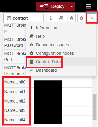

Daikin Cloud Controller instructions:
Requirements:
Your daikin devices set up in the daikin/onecta app.
You will need to have a functioning daikin setup using the daikin onacte app, otherwise your devices will not be accessible through the cloud. The names of the devices you set up in the app will be used to name the devices in domoticz.
A recent domoticz version with MQTT autodiscovery support.
If using an old version of domoticz, you will need to update at least to at least the latest stable release (V2022.1). This node red flow creates and updates devices using MQTT autodiscovery. If you go to the hardware page of your domoticz and can select “MQTT Auto Discovery Client Gateway with LAN interface”, you should be fine.
A working MQTT broker
You will probably already use this, but if not you can always refer to the domoticz wiki page: https://www.domoticz.com/wiki/MQTT
A working Node Red installation, version 2.1.0 or greater
Install node red (for raspberry pi, use instructions at https://nodered.org/docs/getting-started/raspberrypi). You nead at least version 2.1.0 of node red as this is the version where dynamic mqtt subscriptions were introduced. This is used to have custom discovery topics.
Daikin cloud and node red dashboard
I used the daikin cloud integration ( https://flows.nodered.org/node/node-red ... ikin-cloud) to communicate with the daikin cloud, and node red dashboard to have a visual interface for the setup (https://flows.nodered.org/node/node-red-dashboard). As those are not included in node red, you will have to install this separately.
In node red, go to “manage palette” and switch to the “install” tab. Search for each node and click on the install button.
Getting the flow to work:
Warning: I’m not a developer/programmer. This flow was created for my own use. Use at your own risk. I’m sure a lot of code or parts of this flow could be improved. I advise to test it on a test system first. If you have ideas on how to improve this, feel free to leave a comment.
Requirements:
- Open up node red, open the menu ad select Import
- Paste this flow in the new window and click import: https://pastebin.com/PqW2rpMY (Posted on postebin as it was too long to post here).
- Double click the “Configuration File” node. You will need to setup a location to store the configuration files (for domoticz, for mqtt autodiscovery and to store the power usage). Make sure node red can access this location. If this is done, you can click the deploy button. If the folder didn’t exist yet, it should now (hopefully) have been created. If you use node red in docker, make sure node red has access to the folder (by either using the nodered folder, or by adding a bind in your container settings).

Could it be there are spaces in the names of your units? It looks like the error suggest there's a space somewhere, so I suppose it might be the name.
I honestly never tested this as I don't have any units with spaces in the name. Thanks for letting me know, so I can look for a fix.
EDIT: I created a testflow, and the issue is probably due to a space in the name of your device (but I will wait for your confirmation).
There is a function node called "Set Unit Data". Can you test if it works when you replace line 8:
flow.set("NameUnit"+i,msg.payload[i].managementPoints.climateControl.name.value)Code: Select all
flow.set("NameUnit"+i,msg.payload[i].managementPoints.climateControl.name.value.split(' ').join('_'))This is also the reason why the devices are not created for kwh and temperature and that some devices are not being updated.
Not all functions use the name in the variable, so they will probably update correctly.
