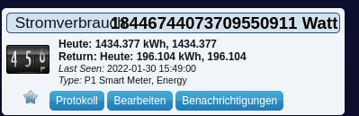

Bildschirmfoto vom 2022-01-30 15-49-51.png (25.62 KiB) Viewed 6966 times
ok, but why still a dot is shown? i activated the p1 "no decimals" in the settings
Re: API script /http polling Powerfox Energy tracker
Posted: Sunday 30 January 2022 16:25
by waltervl

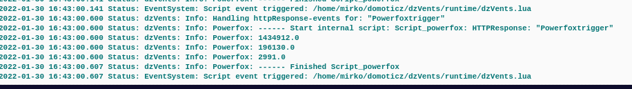

What values are you sending according your log?

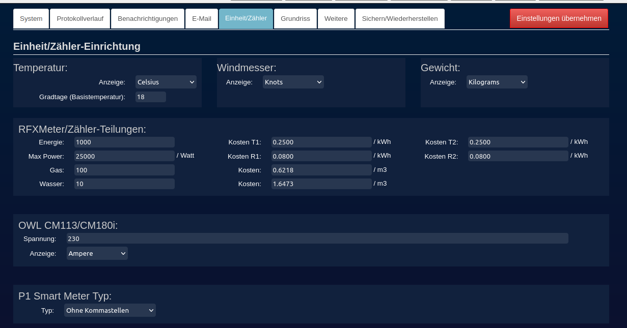

What is the setting of menu Setup - Settings tab Counter?
Posted: Sunday 30 January 2022 16:44
by Mirkoser
Bildschirmfoto vom 2022-01-30 16-44-00.png (74.5 KiB) Viewed 6962 times
Bildschirmfoto vom 2022-01-30 16-43-33.png (56.77 KiB) Viewed 6962 times
Posted: Sunday 30 January 2022 16:46
by Mirkoser
so it should show me 1434 Kwh , 196Kwh , 2991W
If i get a negative value from the powerfox for Watt it will not work and i have no idea how to realize it in the script
