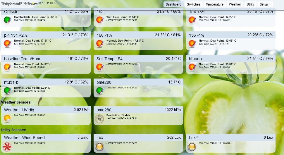

weather sensors (bme280 & a digital uv sensor) not being updated on the main dashboard - they are being updated ok in the weather tab but not dashboard
if i go to weather tab and *then* back to dashboard, the dashboard shows the new readings
ideas ?
weather sensors not being updated on dashboard

Did it work before? Did you update Domoticz recently? Did you clear your browser cache?

i only just added them - the dashboard has a bunch of sensors & it's only the "weather" ones that don't update the "last seen" unless i switch to and back from the weather tab and then they update with the last update - to clarify - they *do* update in realtime on ather tab, just not on the dashboard
edit: i added other sensors after those 2 which update ok, i havent updated, & did clear cache
edit2: the bme280 temp updates on the dashboard, just not its pressure (script sends both data at the same time (+/- 2 seconds)
you can see the dashboard here -
- domoweather.jpg (164.31 KiB) Viewed 571 times
