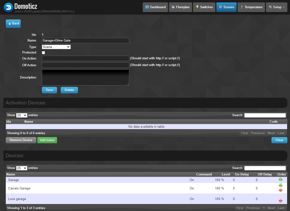

I have a scene named "Garage+drive gate" that turn on 2 relays, one if for the garage door and the second if for the garage drive gate (the switch type for this 2 relays is set to "push on button" with off delay 1s).
What I want to reach is to turn on another relay for the garage light (the switch type for this relay is set to "on/off"), when the scene "Garage+drive gate" is triggered to on, and then turn off the garage light when the scene is triggered again to on.

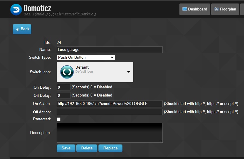

for everyone that need to do that with a shelly 1 or 2.5 relay with Tasmota firmware on board, I created a virtual switch, setup to "push on" with a on command: "http://ip/cm?cmnd=Power%202%20TOGGLE" and off delay 1s.
So now when I switch the scene the garage light turn on with the toggle command of the virtual switch, and turn of when I switch on again the scene.

I have a scene that open 2 drive gates with an ON command (that turns off immidiatly after 1s), what I want is that when turning on the scene that opens the drive gates it turns on also a light, and when I re-turn on the scene it turns off the light.

Thank you for your answer, finally I created a new switch device, set to Push On Button and set a on action with the Tasmota toggle script.waltervl wrote: Thursday 11 August 2022 13:59 If there is no toggle command in the scene configuration for your light device then it is not possible.
I only can think of using the eventsystem to script the same behavior of a scene with a Blockly or dzVents script.
Next I inserted the device to the scene list devices and when triggered it turns on and off
