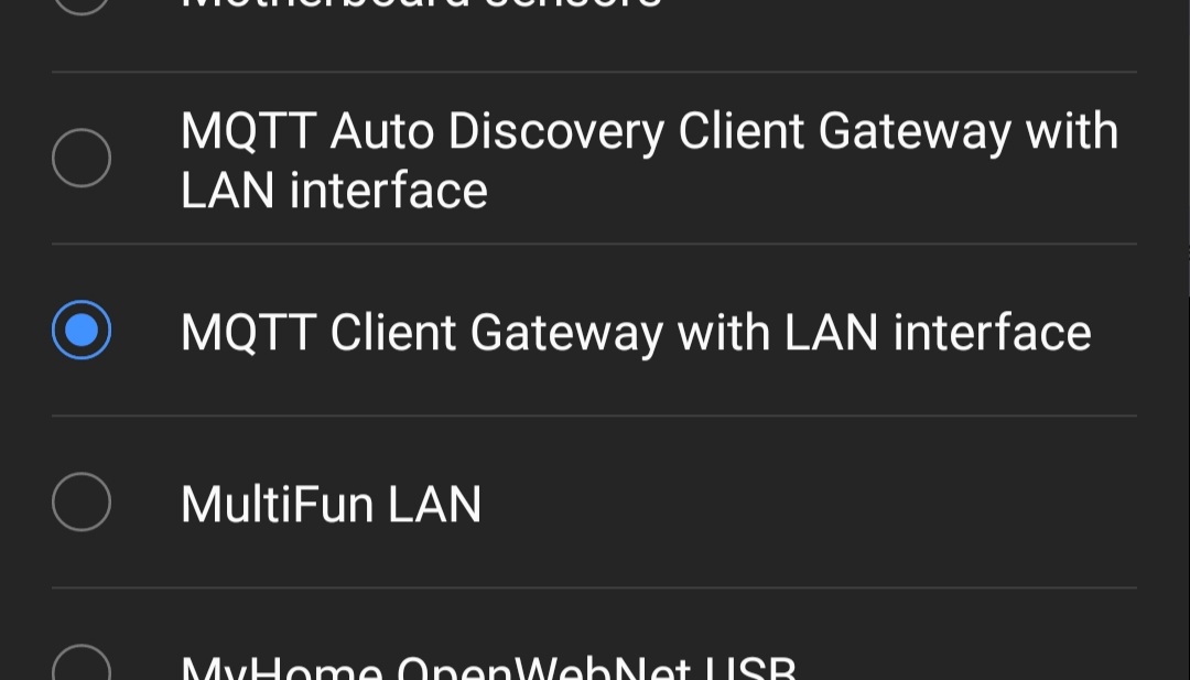

Ah, i found and resolved the issue!
After upgrade the MQTT interface changed somehow from "MQTT Client Gateway with LAN interface" TO "Auto Discovery MQTT Client Gateway with LAN interface".
I never changed this, but it seems that the update did this by itself..
After i changed MQTT Interface back to "MQTT Client Gateway with LAN interface" everything works again!

Probably you mixed MQTT and auto discovery ?
For this very reason it is pulled apart.
Should not give any issues anymore.

I did nothing, only updating..
After update it was on autodiscovery wich didnt worked.
Switched back to normal version was the trick to get it back working.
