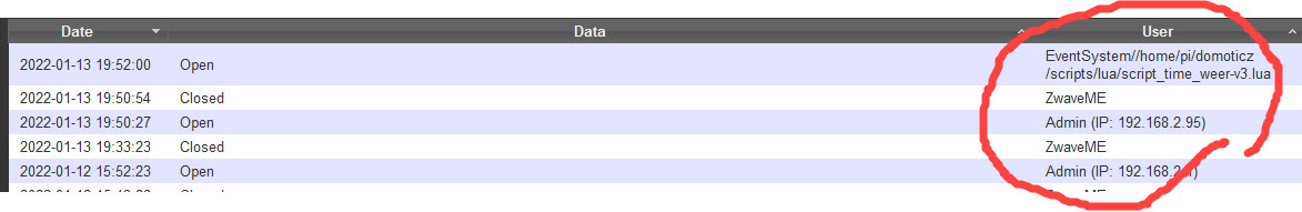

In the log I see the different triggers, but how I get this in a LUA script or dzEvent

Some where on this forum there is a statement of @gizmocuz that the bug is known and not on a high priority.
It will be addressed in the future.
The current bug is only that not the right user is displayed.
You will have to create an issue that it will be placed in the api's.
