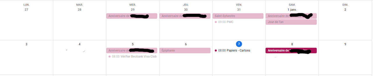

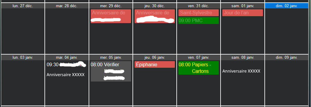

Problem:
Since January 1st my birthdays are no longer displayed, the rest is displayed.
Here is missing 4 and Saturday 8 januari.
Everything is correct in my gmail calendar.
Agenda Gmail :
see : viewtopic.php?p=284498#p284498

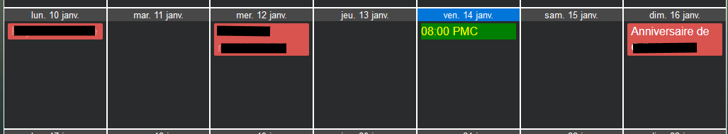

Are these birthdays yearly recurring events in your agenda, or are these birthdays coming from your Google contacts?
Doudy
Posts: 246
Joined: Tuesday 09 August 2016 9:09
Re: Dashticz - Agenda - Birthdays are no longer displayed
Post by Doudy »
These birthdays are recurring events in my calendar

Good news: I've found the bug.
It was in the module that Dashticz uses to parse the calendar data.
I've fixed it in latest beta.
