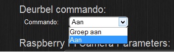

Thats what I want to but what is the status of yours? When I have it like that and the doorbell is pressed the status is always on. So when the doorbell is pushed again nothing happens. Then I have to switch back to "on/off" switch and put it off.
Can it have to be related to this option?
Doorbell Command
Doorbell Command
Greetings Brutus.

markk
Posts: 267
Re: Doorbell
Post by markk »
Doorbells just work like this I think. I have quite a few PIR's that do the same. They always show on but it isn't really an issue for what I use them for. All I need them to do is report a "device change" and, yes, it will issue the on command every time it is activated, even if it is on already. You are obviously disappointed at the fact your doorbell always shows as "on" but I don't understand what this is preventing you from acheiving!
